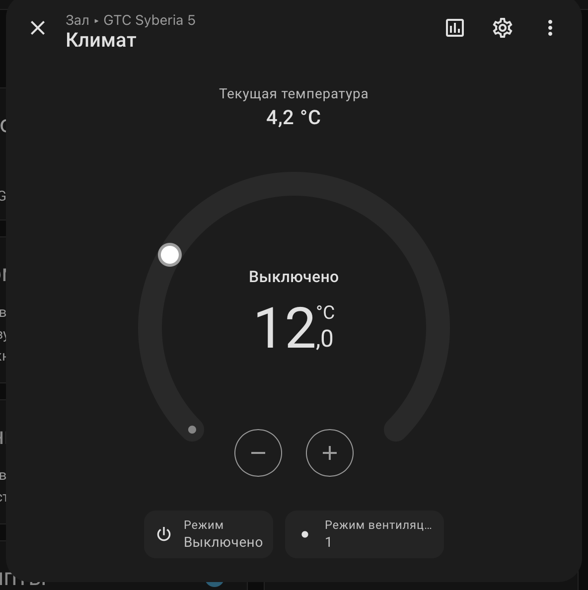

I want to share a custom integration I’ve been working on for Ventmachine air handling units (equipped with GTC, Syberia 5, or similar controllers) that communicate over Modbus TCP.
:star2: Key Features
  • Native Climate & Fan Entities: Full control over your HVAC system. Includes target temperature setting (strictly clamped to the hardware’s 5.0–30.0 °C range) and smooth 10-step fan speed control.
  • Auto-Hardware Detection: The integration reads your specific configuration directly from the Modbus registers (Heater type, Cooler, Recuperator) and displays it elegantly in the Device Info card.
  • Semantic Alarms: All hardware faults and warnings (Fire, Freeze threats, Overheating, Filter limits) are mapped to standard Problem binary sensors for proper history coloring (Red/Green) out of the box.
  • Transparent Process Tracking: Instead of basic ON/OFF states, you get detailed text sensors for current mechanical operations (e.g., “Opening damper”, “Preheating”, “Coasting”).
  • Sensors: Read actual fan RPMs, operation countdown timers, and the next scheduled start time from the built-in controller (these are hidden by default to keep the UI clean if your specific unit lacks the physical sensors).
