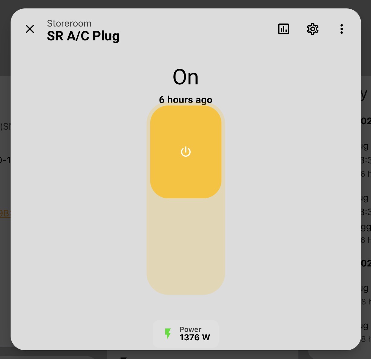

I dont know if this is of use to anyone else but "i" (read: AI) have made a card mod for lovelace that shows the power usage of a switch / device on the more info card like below:

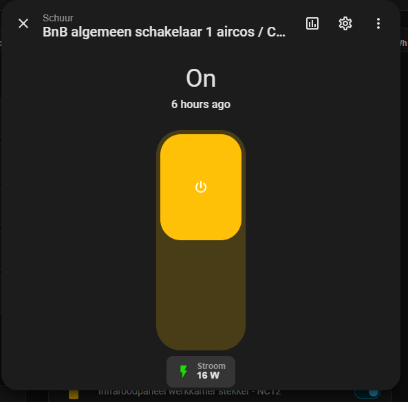

Show live power usage in Home Assistant more-info dialogs. Power More Info is a frontend-only Lovelace dashboard resource for HACS. It adds a compact, clickable wattage badge below supported controls when the opened entity has a matching power sensor.
It is built for smart plugs, switch entities, lights, fans, appliance plugs, Zigbee/Z-Wave plugs, Tuya plugs, Shelly devices, energy monitoring sensors, and Home Assistant dashboards where you want instant watt values without editing every card.
Power More Info screenshot in a Home Assistant more-info dialog

  • Adds a live W badge to Home Assistant more-info dialogs.
  • Works with switches, lights, fans, and other controllable entities that have a related power sensor.
  • Keeps sensors, helpers, scripts, scenes, buttons, diagnostic entities, and unrelated entities out of scope.
  • Shows a compact card-style badge with a green flash icon and current watts.
  • Opens the matched power sensor history graph when the badge is clicked.
  • Preserves the original more-info control spacing and avoids slider overlap.
  • Supports Dutch and English labels automatically.
  • Requires no dashboard YAML changes and no per-card configuration.

Wow, this works great!! I never knew this was possible, and I'll definitely be keeping it! However, it does not work with lights (and likely fans and such); do you think you could add that? Or are you purposefully keeping it switch only?
(E.g light.sr_inovelli with sensor.sr_inovelli_power (W))
Also, I've just noticed a bug. It adds the badge to every related popup, even the recreate entity IDs menu :rofl:
Edit: happens when you open the switch more info and then any other sensor from the device page. A browser refresh fixes it.
Edit 2: if you open any switch that has a power sensor, it causes the badge to appear on EVERY popup until a reload.

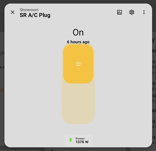

Sure! The latest update has made it way better and the problem is gone. Only thing I see is that it pushes the switch too far up. (I tried with like 6 different versions just to make sure)
Looks better with the latest update 0.2.9:

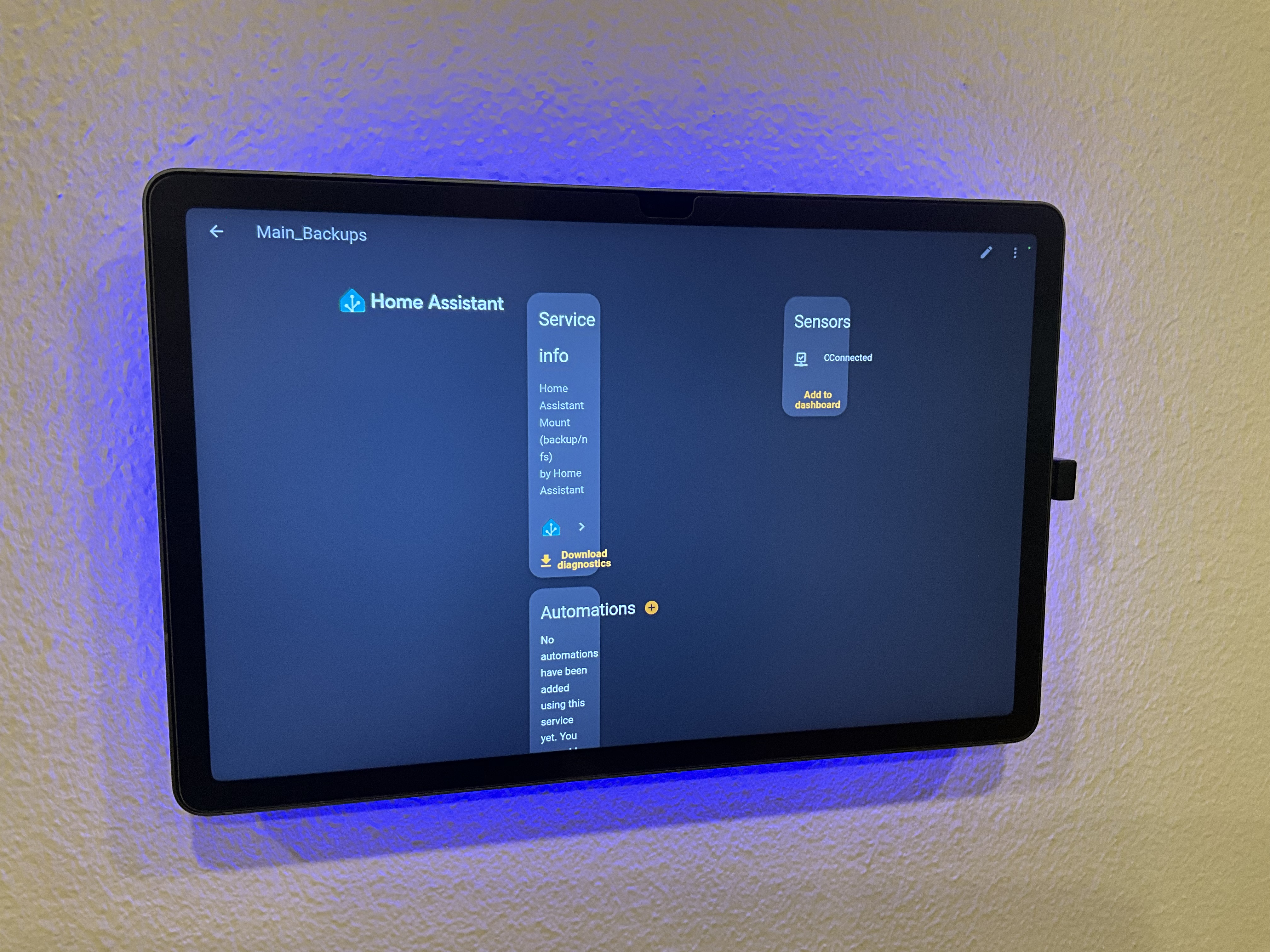

I wish I could say it was issue free but unfortunately, at least when using Browser Mod, this happens. In fact, I mistakenly filed an issue over at [Bug]: Devices page gets squished when Browser Mod is enabled. · Issue #1300 · thomasloven/hass-browser_mod · GitHub
i see, my bad. i was working on this matrover/ha-device-overview-responsive: Home Assistant integration for responsive device overview columns
but they got mixed up. fixed now.
