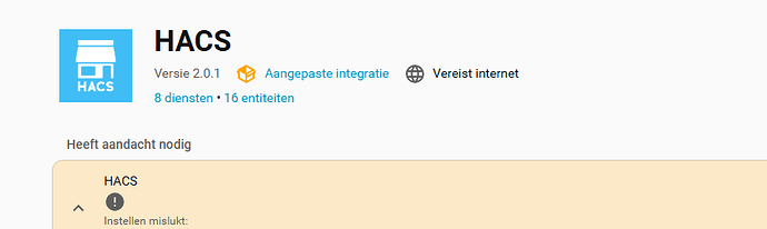

Hacs was working fine. Now all the HACS integration do not work any more. I think the HACS update failed, but I am not sure.
How should I procede to solve this problem?

HACS is pretty ok to me, please see HA update broke my HACS - HACS
seeing your version on 2.0.1, i think its indeed time for some attention :slight_smile:
How can I update or re-install HACS?
There is no Update request for HACS when I look in Settings
check on menu /config/updates and check the box ‘show skipped’.
If it doesnt show there, better remove the integration and re-add it…
