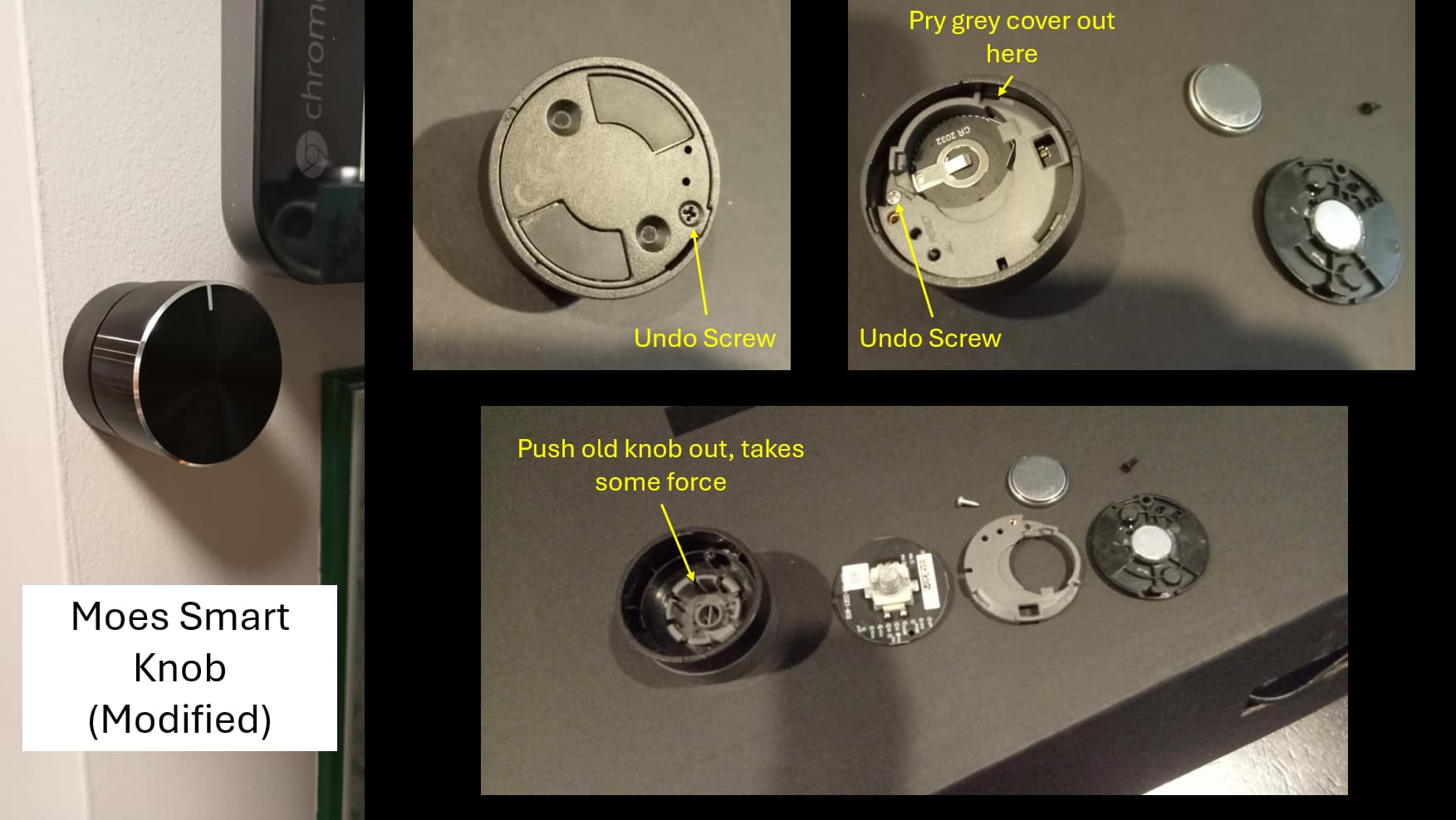

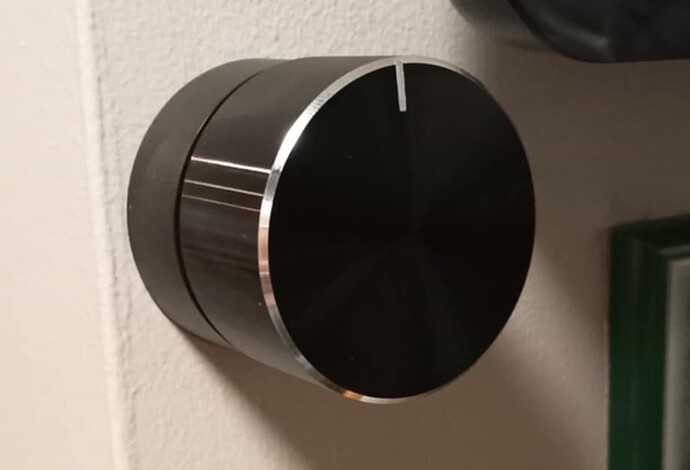

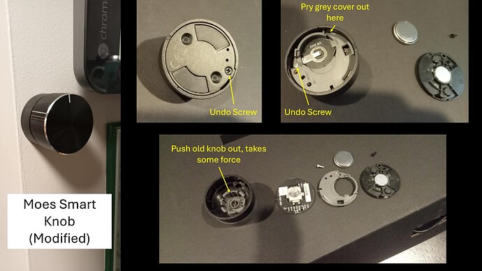

The Moes Smart knob is handy for lights and volume but it looks a bit drab.

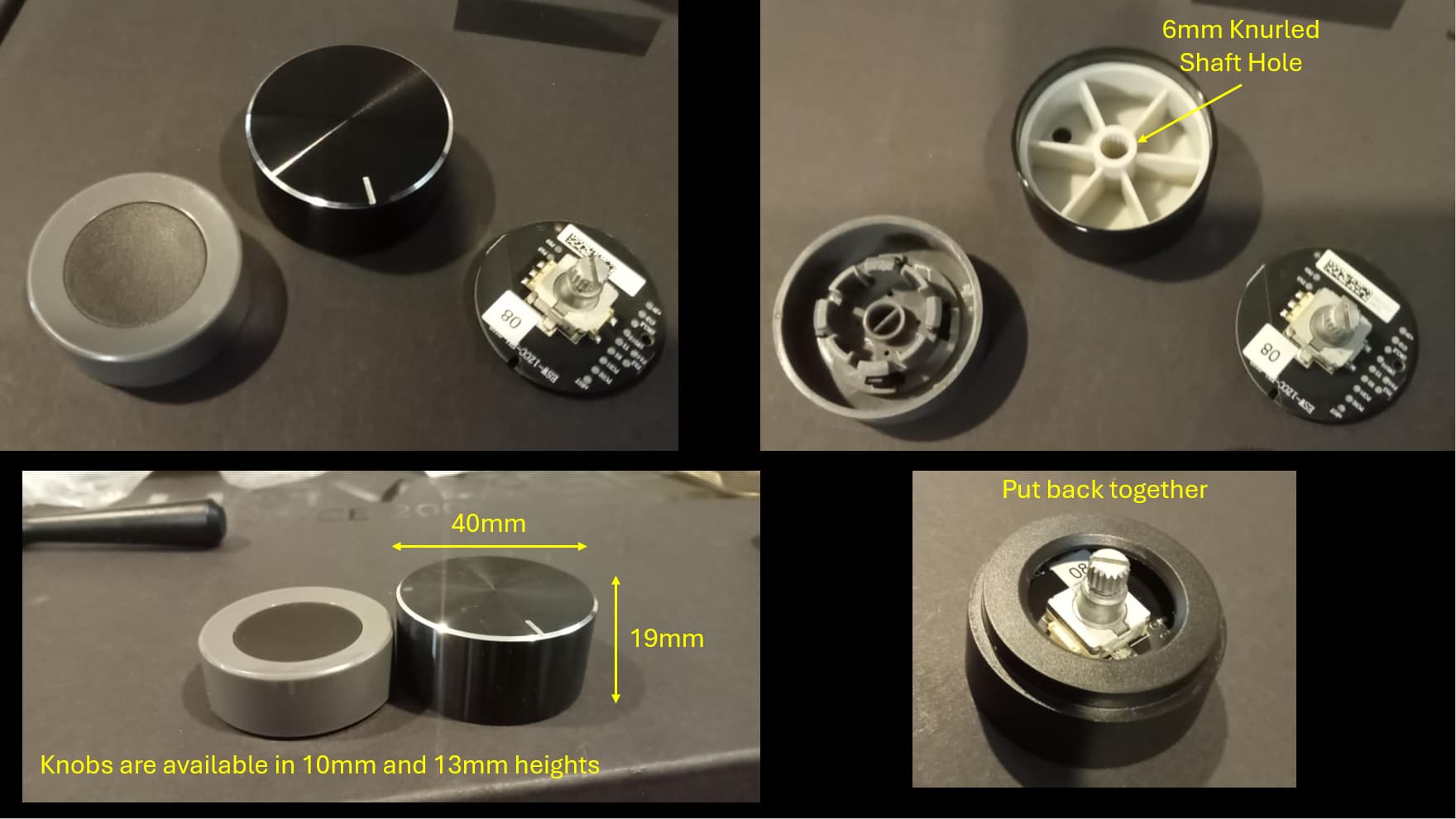

I needed a little more Home Approval Factor (HAF), so I brought some very cheap aluminium knobs off Aliexpress.
Specs
  • 40mm Diameter
  • 19mm Height (10mm-15mm may have been better
  • 6mm knurled shaft hole (Don’t get the ‘D-Shaft’)
Links (I am not affiliated in any way)
Instructions
Final Product

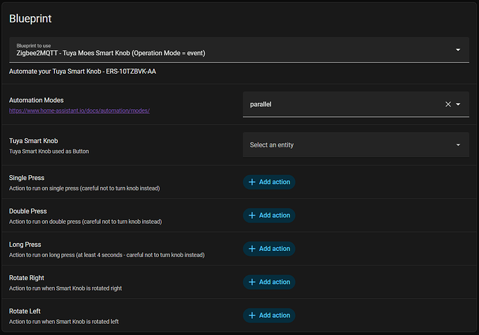

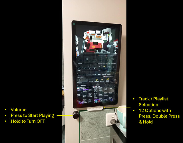

Automations
Implemented with Zigbee2MQTT
Zigbee2MQTT - Tuya Moes Smart Knob (Operation Mode = event)

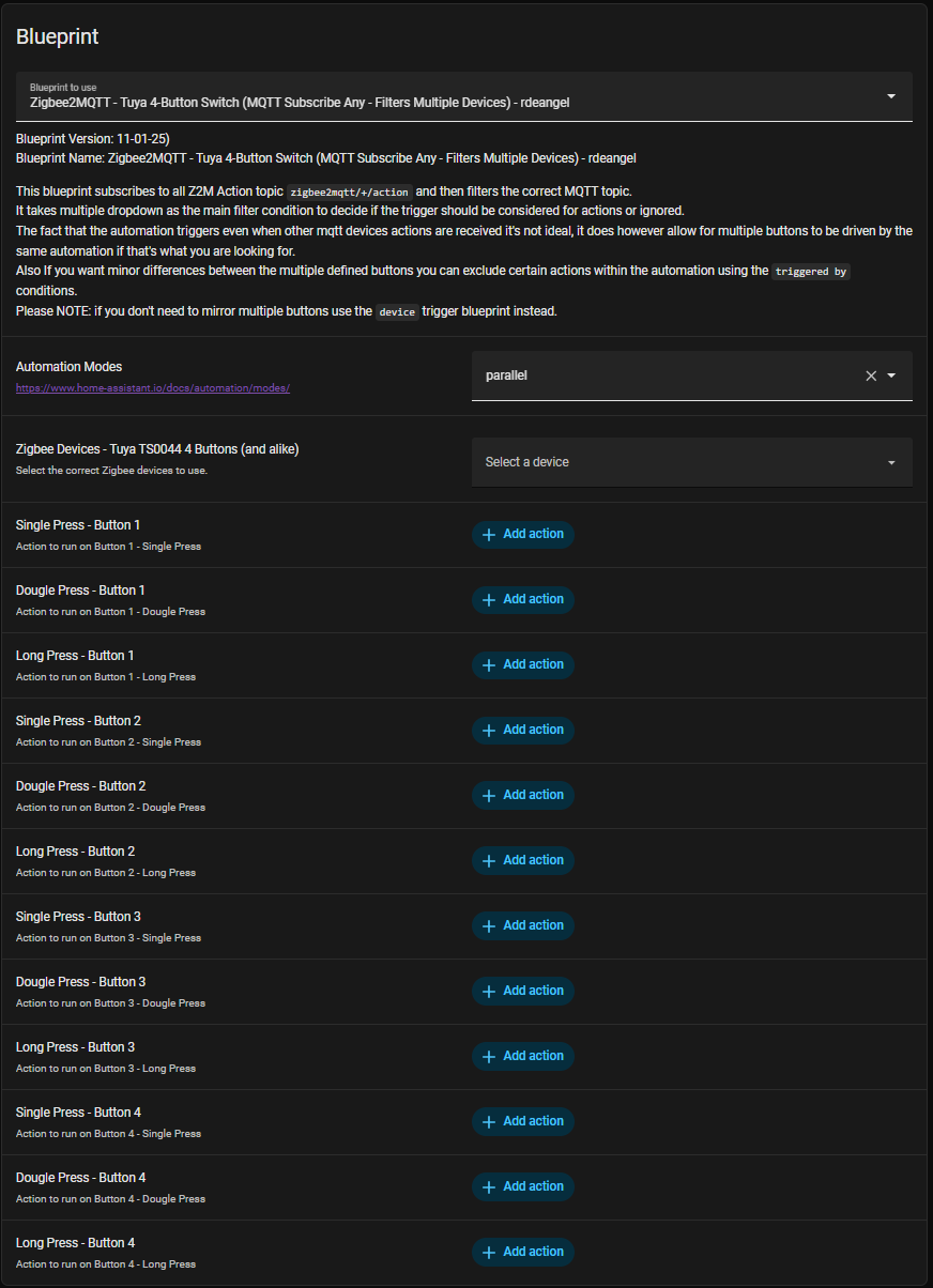

Zigbee2MQTT - Tuya 4-Button Switch (MQTT Subscribe Any - Filters Multiple Devices) - rdeangel
Click the badge to import this Blueprint:
Zigbee2MQTT - Tuya 4-Button Switch (MQTT Device Trigger)
Blueprint moved to github.
The blueprint filename has changed if you used a privious version of this blueprint see here how to avoid having to rewrite your automation manually after switching the blueprint.
Alternate Blueprint
Here is an alternate blueprint if you want to automate multiple devices (of the same type) in with the same actions maintaining a single automation.
