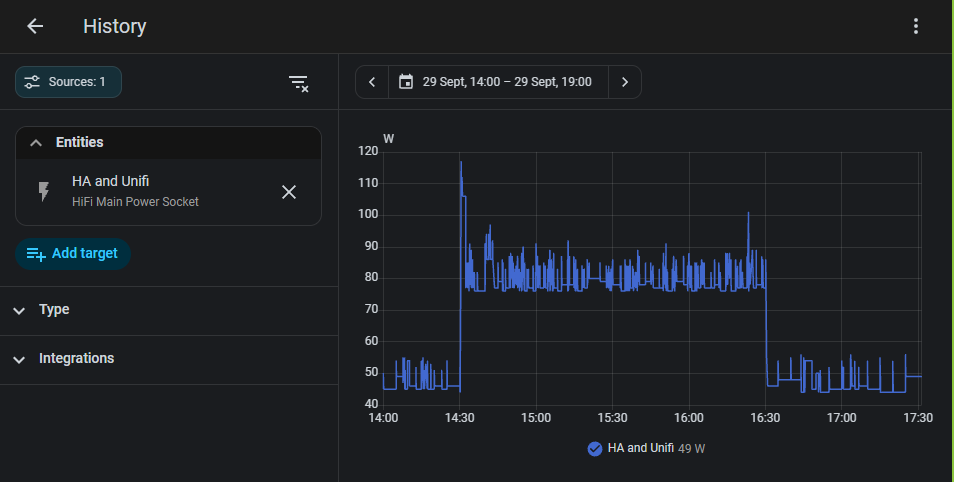

For now I’ve uninstalled it as I have some clean-up to do. Not sure if it was because I have an external MariaDB DB but the power pull on my GMKTek M5 Ultra almost doubled. I was using the dashboard cards.
Hey thanks a lot for reporting this with a graph, that’s really helpful. A few questions so I can narrow it down: Which HA version and install type, roughly how many entities, and was a dashboard with the HAGHS cards open during that time (for example on a wall tablet)? Did you use HAGHS before this beta, and if so, did you see the same with v2.3.0? If you find the time later: running HAGHS for 30 minutes without the cards would tell us whether it’s the integration or the cards. And where does your MariaDB run, on the same machine?
I’ll do this for you tomorrow. I’m not near my laptop at the moment :+1:
MariaDB is on the same machine.
