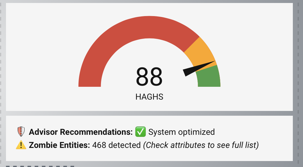

Made me wonder though , why are the zombies bad at all, or rephrase , count against health.
Also, having over 400/600, I dont think we should list them in the attribute.
That is worse for the system in itself

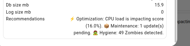

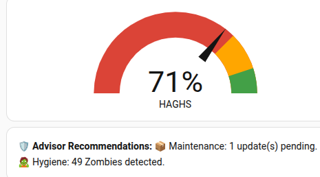

I cannot seem to find this update that it is referencing… is it logged in more detail anywhere?

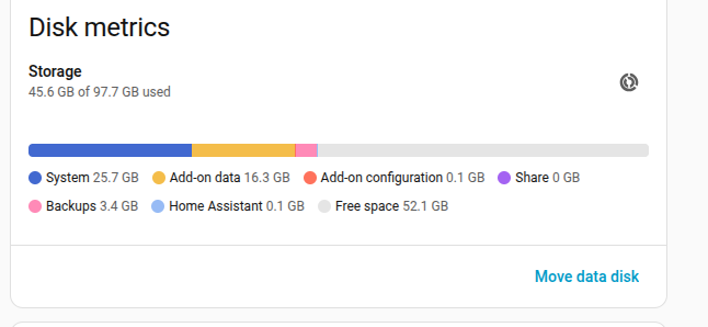

I doubt I can get much better, maybe into the mid 70’s - it’s running on i5 4 cores with 16GB ram and like 97 GB of storage but I just installed Music Assistant and Voice w/local TTS and AI.

80% disk space warning on a 2 tb disk is pointless.
You could make it staggered or use a fix value which at least should be available.
hi. great questions. zombies count against the score because they represent maintenance debt. an unavailable entity often means a broken automation, a dead battery, or a zigbee device that lost its route. these create noise in your logs and make your system less predictable. it is about hygiene, if you dont need it, remove it. if it is seasonal, use the haghs_ignore label.
regarding the attribute size: while the dashboard card uses collapsible rows to stay clean, the underlying state machine still has to carry that 400+ entity string. for v2.2, i will implement a cap on the attribute list to prevent state bloat, while keeping the total count accurate. thanks for pointing out the impact on system performance.
hi. haghs checks all entities in the update domain. if the advisor is nagging you but you dont see anything in the main update notification, check settings > system > updates.
sometimes updates are marked as ā€˜skipped’ or are hidden because of pending dependencies. haghs still sees these as ā€˜pending maintenance debt’. if it is a legacy update you cannot perform, you can use the haghs_ignore label on that specific update entity to stop it from affecting your score. v2.2 will actually list the specific update name in the attributes to make this easier to track.

regarding disk space: i agree. for the next update i will look into changing the logic to a staggered approach or a minimum absolute threshold (e.g., warning only if less than 10gb or 15% remains, whichever is more sensible).

Thanks - I found it. It was a manual integration reporting an update available and I did not have it as an entity on my normal view for those type of things.
Still surprised at this rating - 86% on system with 4 CPU Cores with 16GB ram and 100GB storage at 49% full.
Seems to be CPU Load as I hover at 13-15% load with all the integrations and add-ons.

yes, the current 10% cpu threshold is quite strict for your setup. v2.2 will fix this by switching to psi (pressure stall information). instead of raw usage, we’ll measure actual resource ā€˜pressure,’ making the score much fairer for powerful hardware. check out the roadmap on r/haghs for more details.

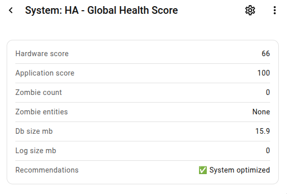

Spent the day cleaning up zombies, ignoring seasonal items, and shrinking my database from 34GB to 72MB (yes, those units are correct, had to use VACUUM to get it to work)
Was getting excited as my score kept going up, but now everything reports fully optimised and only has a score of 86%.
How can I achieve 100% if nothing is reported?
