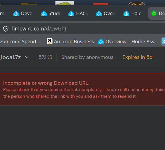

Just what I’ve been looking for. I have my Air con running via Smart Air 2 & Smart Clima Apps, but cant get it running on HoN. Please let us know when you fix the borken link that has been shared.
Will upload again… sorry for the inconvenience Download haier_local.7z | LimeWire
Please let me know
EDIT: I was not receiving any notification from the post… sorry for the late reply
EDIT 2: I had recorded a small video to show it is working but forgot to upload…
Here it is: Watch PXL_20260716_163128975 | Streamable
hOn i belive is already supported in an integration in HACS… I saw a few months ago… my AC is still on the SmartAir2 app
Anyone was able to test?
I was able to download from the second link.
However, as per the notification, it will expire in 4days, so… probably Limeware isn’t the best place to put it…
BTW, you should also consider changing the original post link, as it is broken

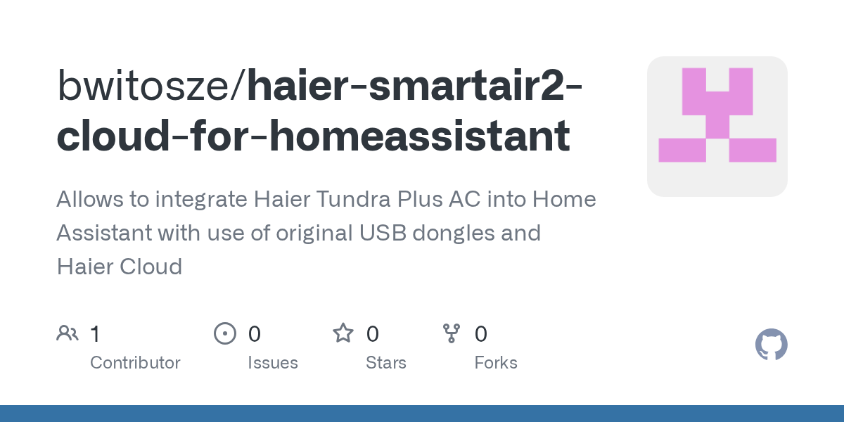

I know this thread is about local integration, but there are no threads about cloud integration because nobody has made one so far for SmartAir2
Still, this may be of interest to someone — I created (with a little help from AI :wink: an integration that works through Haier’s cloud and can be installed via HACS.
It works with the original USB dongles supplied with Haier Tundra Plus air conditioners, so there is no need to replace them or install ESP32-based alternatives.
It does, however, require an account for the SmartAir2 app (not hOn!).
More information is available in the repository’s README.md.
