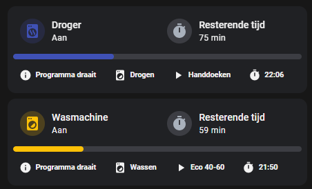

After getting a new washer and dryer, I searched for some Lovelace cards that fitted well into my dashboard which uses mushroom cards.
The most visually appealing for me was from UI Lovelace Minimalist.
Yet not wanting to use that I made my own. Just posting here for anyone else to use.
End result:
Device on:
The card only displays the entity as off without the additional items.
The card uses these HACS items:
custom:stack-in-card
custom:timer-bar-card
custom:mushroom-entity-card
Haier hOn Revived - (GitHub - mmalolepszy/hon-revived: Home Assistant integration for Haier hOn: support for Haier/Candy/Hoover home appliances like washing machines and air conditioners in 28 languages.)
To start I made some additional sensors.

this makes sure that the remaining minutes are displayed as 0:10:00 format instead of just 10 and that the start&end time are dispayed like “YYYY-mm-ddTHH:MM:SS” in order for the timer bar to work.
  1. Addes this card yaml to the dashboard:
