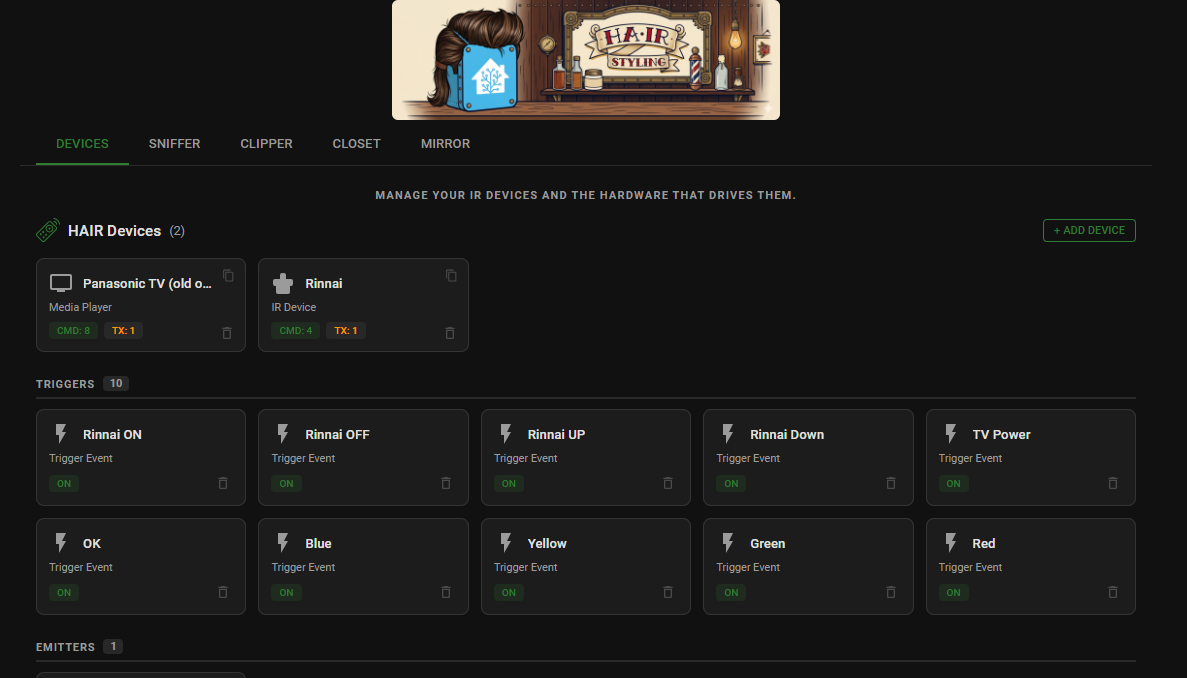

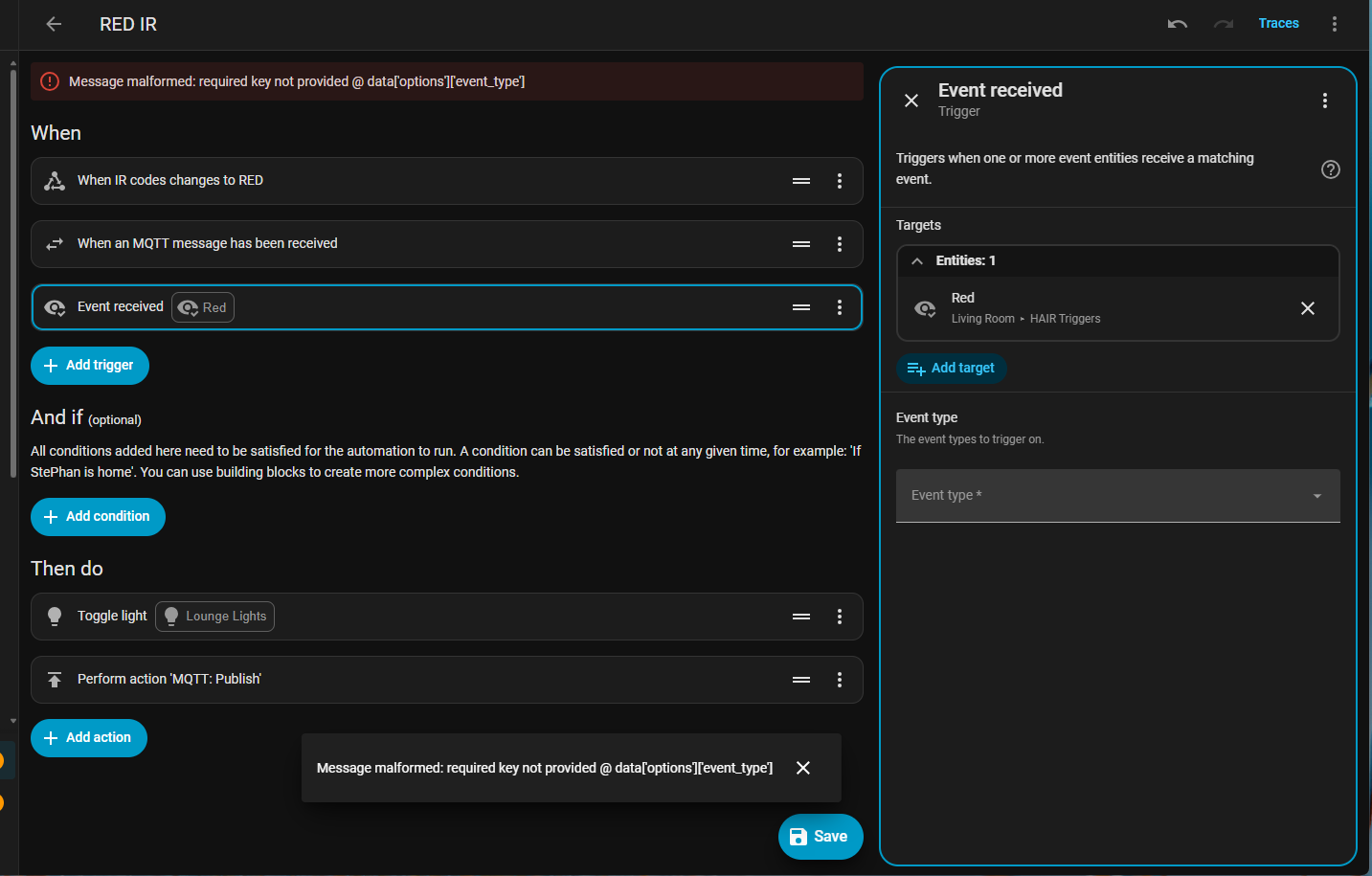

Add some commands
now want to add the event trigger a automation
Im getting
Message malformed: required key not provided @ data[‘options’][‘event_type’]
That’s the Event type field just under the entity, it’s required and empty at the moment. Open it and pick ir_command_received, it’ll be the only one there, then it should save.
I’m looking at making these show up as proper device triggers so you’d just pick the button and be done. It’s on my bench.
Let me know if that dropdown turns out to be empty when you open it, that’d be something else entirely.
~ DAB
Thanks Bro
Got it working

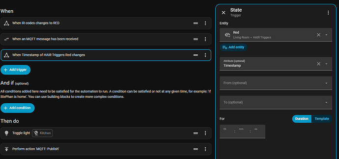

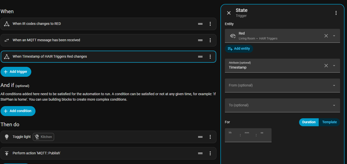

had look at the STATE
NOTE:
the way the remote fires the command press it once it the remote would send more than one command so the light would toggle on/off :frowning: but by adding 2 hits
It did it job
THANKS again for the great work you have done.
