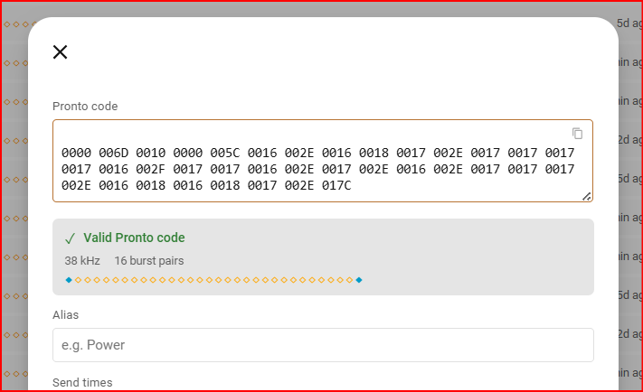

Thanks for the screenshot, that helped.
Your Athom is actually working. The badges are throwing you off. RX-NATIVE means HAIR is hooked into the receiver through HA's modern infrared platform. RX-BRIDGE is the older path and only shows when the legacy on_pronto bridge in the YAML is still firing. We removed that from the example for HA 2026.6+, so your Athom doesn't have it. Your "Sitting IR" device still has the old bridge in its YAML, which is why it shows both badges. The Athom is on the cleaner setup, not missing anything.
On the Sniffer issue, a few things to check:
  • Is the Sniffer tab empty when you press a button, or does it show signals from other devices but nothing from the Athom?
  • Have you tried Show Dismissed? If the source remote got dismissed, signals are hidden.
  • Could the signal be landing on a HAIR device instead? In 0.4.0 we match known commands and surface them on the device card, not the Sniffer.
  • Have you restarted HA since adding the Athom? HAIR's receiver subscription happens at startup.
Let me know what you see and we can dig in.
Also unrelated... your rf_off_trigger Pronto looks truncated, ends with '0009000 instead of a proper closing word. Worth a look.

A couple updates since the launch post. :clinking_beer_mugs:
v0.4.0 added protocol-decoded transmit (currently NEC):
  • Clean re-encoded Protocols (currently NEC) timings on Test and automation, which fixes replay against destinations that reject jittered captures. A per- command toggle keeps the captured timings for the rare device that needs them.
  • Code-library picker on the Clipper tab for pre-filling a remote from supported manufacturer/model combos in your installed infrared library.
v0.4.20 added a unified Pronto editor and a handful of related polish:
  • Edit a Pronto code in place on any signal or command; HAIR re-evaluates it as a fresh capture and bound triggers re-point automatically when the fingerprint shifts.
  • One-click snap of off-standard carriers to the nearest IR standard (30/33/36/38/40/56 kHz).
  • Rename a device command with action mappings cascading to the new name.
  • Per-command send-N-times count for devices that need a repeated frame to register.
Full changelog: HAIR/CHANGELOG.md at 5cb7be80b3867d9f3ea5cd1521858e23120bdd94 Ā· DAB-LABS/HAIR Ā· GitHub

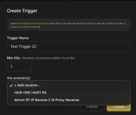

I've got HAIR v0.5.6 installed and am trying to get it set up with a couple of remotes and a generic ESPHome setup. I'm building a system to trigger actions in Home Assistant with IR remotes, so I can control lights and fans (etc) in a room without having to use an app. I'd previously manually mapped remote buttons in ESPHome to trigger events, which works well, so I'm confident my hardware setup is viable. I've also got the new infrared hub set up in my ESPHome.
When I first installed HAIR, nothing showed in the sniffer, with multiple remotes. It wasn't until I did Settings → Devices & services → Integrations → HAIR → Hubs / HAIR → Reload. Then the sniffer started working.
I've played with 2 remotes so far. One is a generic thing that I think is supposed to be a replacement Roku remote. The other is a Sony RMT-B119A. The Roku is registering individual button presses fine, grouped under a single remote. The Sony, on the other hand, hardly ever shows the same signal twice, and is registering as multiple devices. Maybe the batteries are dying? I'll try that, but something is definitely fishy there.
I'm confused by the trigger mechanism with in HAIR. I don't really care about emulating the entire remote: I'm not trying to control an existing device via IR, I'm trying to use the remote as a control surface for HA, and my goal is to have identical receivers and IR remote controls in multiple rooms. The trigger mechanism appears to only fire when a button is pressed, without any kind of differentiation as to where it was received. If I hit the mute button in the garage, I want to mute the audio in the garage, but the trigger just says "the mute button on A remote was pressed" without telling the listener what received the signal. Is there a way to do that?
Thanks,
Brian
The workaround I'm using is to use get the entity ID of the last active infrared entity:
triggers:
  - trigger: event.received
      entity_id: event.hair_trigger_test_button
    options:
      event_type:
        - ir_command_received
variables:
  last_ir_entity: |
    {{ states.infrared | sort(attribute = 'last_changed', reverse=true)
    | map(attribute = 'entity_id') | first }}
actions:
... you can use that directly or use it to get the Area with area_name().
But I agree, the receiver's device ID should really be part of the event data.
That's a heck of a workaround, but well done!
Great idea! Thanks for the work around @Didgeridrew. I’ll scope a solution when I’m back from the flu. :face_with_thermometer:
~ DAB
Finally over the flu (and so is the rest of the house, almost), so I'm back. :clinking_beer_mugs:
v0.5.7 just shipped: Release v0.5.7 -- Location Awareness + Dots Ā· DAB-LABS/HAIR Ā· GitHub
Big one this release is location-aware triggers, straight out of the conversation @blalor and @Didgeridrew started upthread.
Every trigger event now carries receiver_entity_id, receiver_area_id, and receiver_area_name, resolved live at fire time.
The trigger dialog also gets a multi-select Receiver scope, so the same physical remote button pressed in the garage vs the living room can drive two separate triggers with two separate names. No Jinja gymnastics needed. Thanks to both of you for the report and the design pressure.
Also folded in a Spanish translation for the config flow from @Waterbrain, plus a corner-dot polish pass on the signal-row Assign and Trigger buttons so counts and state are visible at a glance.
HACS should pick it up within a few minutes. Full notes on the release page above. :barber_pole:
