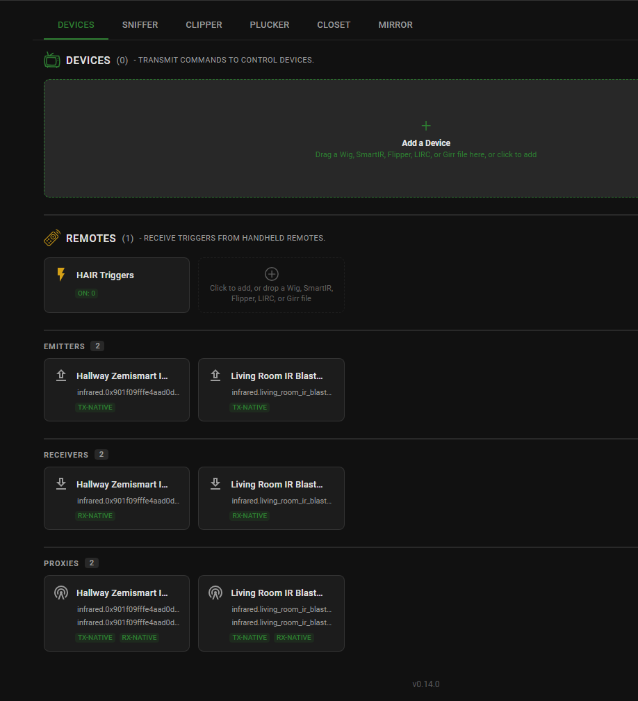

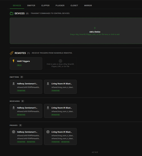

My 2 IR devices are showing up as emitters, receivers and proxies but sniffing doesnt seem to work. When I want to learn new codes, I go into MQTT and turn on ‘learn ir code’. These devices are the Tuya based zigbee battery operated IR blasters so perhaps having the learning mode on drains the batteries. Anyone else go these working? The model is a Zemismart TS1201
thanks for the info about the fan card, I don’t quite understand this aspect of HA yet but I’ll take some time to learn @DAB-LABS
I don’t quite understand what is and isn’t compatible as Sniffers with HAIR
I picked this up and doesn’t show up under Sniffer
device is paired with Z2M and shows up in HA, is there something else required to make this work in HA?
