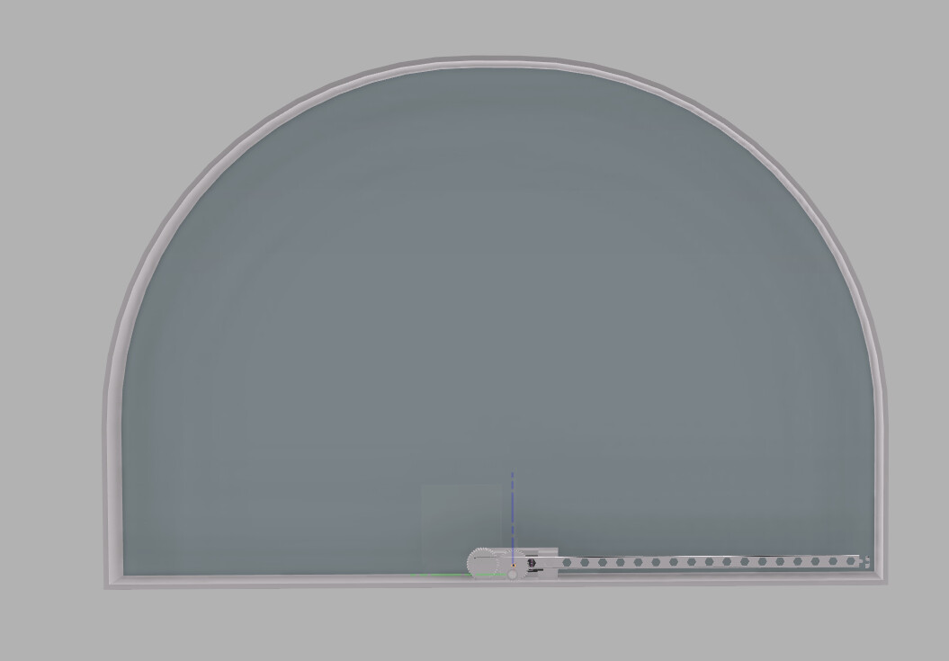

Hi there, I've been working for a week on a system to integrate into homeassistant so I could put a otorized window shade on an arch window I have in my living room. However, after re-measuring I realized it's not a perfect semicircle, but rather an elongated semicircle (flat edge is taller).
The original system I had wouldn't work, as it would only open a shade 180° and leave a crescent on the top.

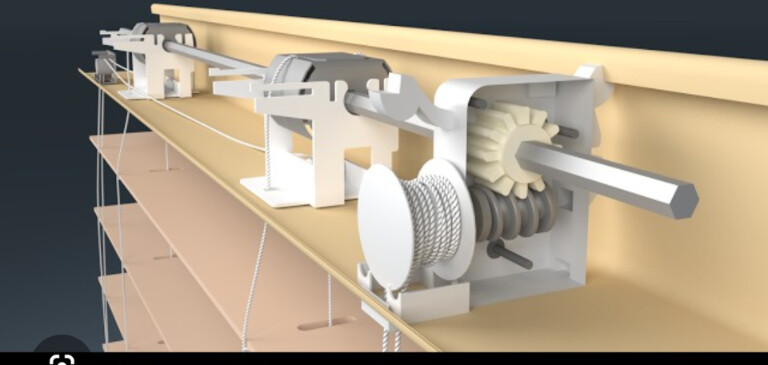

I'm currently thinking a stepper motor or continuous rotation servo in the base that rotates a geared shaft, and then a separate worm gear similar to how venetian blinds work that rotates a wheel with my wrapped up cord.
