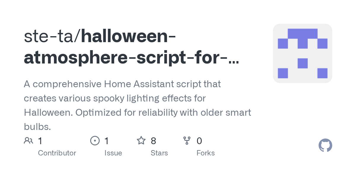

GitHub Repository:
Quick Install:
  1. Copy the script from the repository
  2. Go to Settings → Automations & Scenes → Scripts → Add Script
  3. Edit in YAML and paste
  4. Save!
