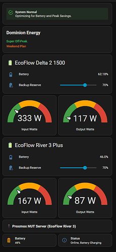

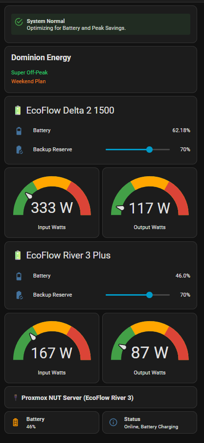

Um… backups? If you don’t want to use it, you don’t have to, but I had it create a Power-Company Peak/OffPeak/Superoff Peak widget, that live updates from my power company, and use it, along with Weather Alerts, to configure my two EcoFlow UPS’s, to run between 30-80 depending on Peak and fill to 100 if there is a storm warning. Took about 5min to get it 100% right. It also configured a NUT server on ProxMox (which required compiling from source) and then added the NUT to HA. I could have done maybe 50% of that on my own, in 30min, and the other 50% would have taken hours of research for me, without AI… instead AI did 100% of it for me in 5 after a nice discussion about what I would like.

While I probably could have improved my power dashboard myself in about the same amount of time… it was just more fun asking the AI to do it for me and giving feedback and trying differant things out. The dashboard updates live in real time live in the browser as the AI edits it for you over ha-mcp.
