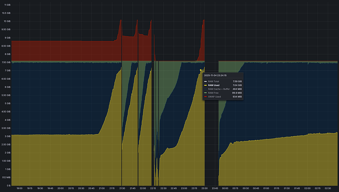

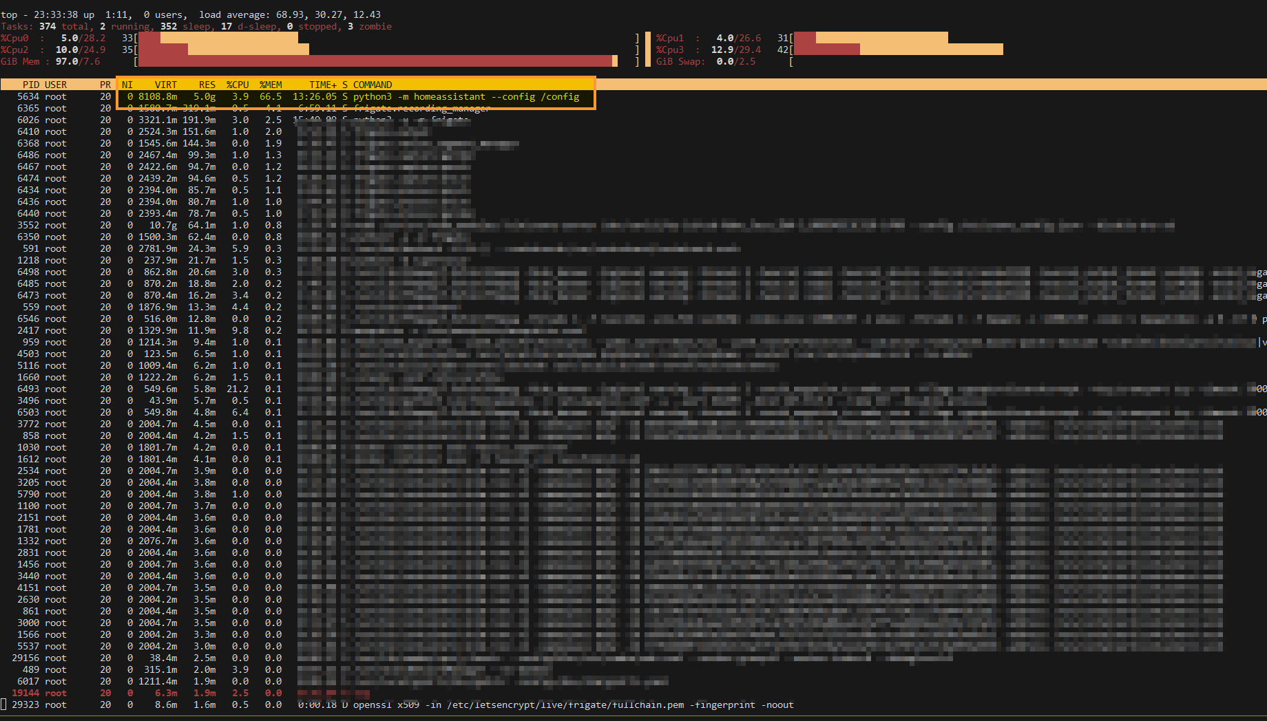

Starting a few days ago I discovered a memory leak in the main homeassistant container. The main python process would balloon in RSS, consuming all memory & swap, triggering the OOM-killer.

The automation was actually unused, so I simply disabled it. I don’t know what’s made it problematic now as it has been unchanged for months (maybe something in a recent upgrade, but I can’t narrow it down to one off the top of my head).
