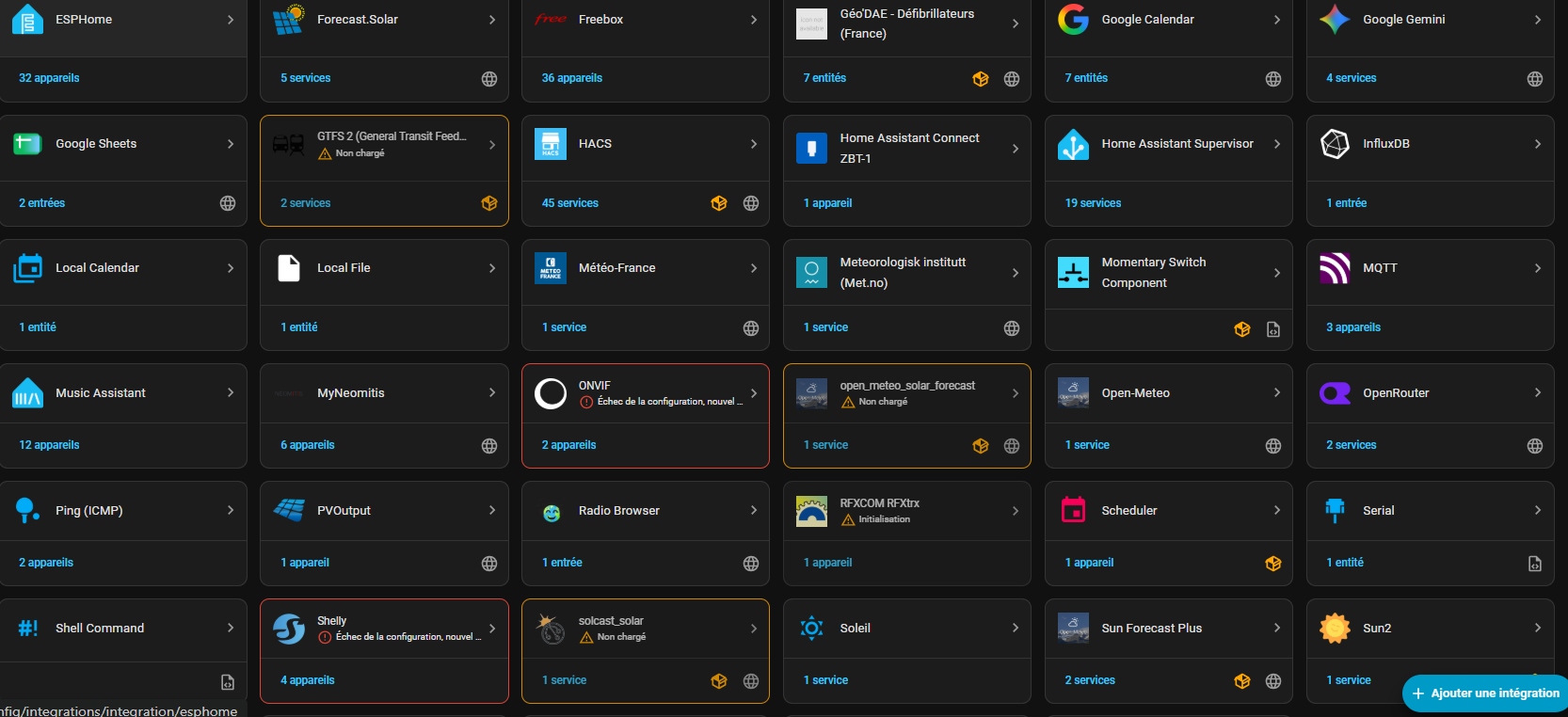

After upgrade I had several notifications telling at least 3 of my HACS integrations all with API connections were not loaded.
For Vigieau :
Cette erreur provient d'une intégration personnalisée.
Logger: custom_components.vigieau
Source: helpers/update_coordinator.py:512
Intégration: Vigieau (Documentation, Problèmes)
Première occurrence: 11:00:11 (1 occurrence)
Dernier enregistrement: 11:00:11
Error fetching vigieau api data: Error communicating with API: Cannot connect to host api.vigieau.beta.gouv.fr:443 ssl:default [DNS server returned answer with no data]```
For met.no
Logger: homeassistant.components.met.coordinator
Intégration: Meteorologisk institutt (Met.no) (Documentation, Problèmes)
Première occurrence: 10:58:53 (1 occurrence)
Dernier enregistrement: 10:58:53
Error fetching met data: Update of data from the web site failed:
Logger: metno
Source: components/met/coordinator.py:78
Access to https://aa015h6buqvih86i1.api.met.no/weatherapi/locationforecast/2.0/complete returned error ‘ClientConnectorDNSError’
For openmeteo:
Logger: homeassistant.setup
Source: setup.py:276
Première occurrence: 09:59:26 (3 occurrences)
Dernier enregistrement: 10:00:27
Setup failed for custom integration ‘open_meteo_solar_forecast’: Requirements for open_meteo_solar_forecast not found: [‘open_meteo_solar_forecast==0.1.32’].
Setup failed for custom integration ‘solcast_solar’: Requirements for solcast_solar not found: [‘watchfiles>=1.0.0’].
for gtf2 :
Setup failed for custom integration ‘gtfs2’: Requirements for gtfs2 not found: [‘gtfs-realtime-bindings==1.0.0’]. ```
and some related error I think
Logger: homeassistant.util.package
Source: util/package.py:222
Première occurrence: 09:59:10 (9 occurrences)
Unable to install package watchfiles>=1.0.0: error: Request failed after 3 retries in 9.7s Caused by: Failed to fetch: `https://files.pythonhosted.org/packages/8f/95/8ef4a95481d3e0cb52d62a06fa6e972e81424be2d9698b91a2fecca9904c/watchfiles-1.2.0-cp314-cp314-musllinux_1_1_aarch64.whl.metadata` Caused by: error sending request for url (https://files.pythonhosted.org/packages/8f/95/8ef4a95481d3e0cb52d62a06fa6e972e81424be2d9698b91a2fecca9904c/watchfiles-1.2.0-cp314-cp314-musllinux_1_1_aarch64.whl.metadata) Caused by: client error (Connect) Caused by: dns error Caused by: failed to lookup address information: Name has no usable address
Unable to install package watchfiles>=1.0.0: error: Request failed after 3 retries in 11.2s Caused by: Failed to fetch: `https://files.pythonhosted.org/packages/8f/95/8ef4a95481d3e0cb52d62a06fa6e972e81424be2d9698b91a2fecca9904c/watchfiles-1.2.0-cp314-cp314-musllinux_1_1_aarch64.whl.metadata` Caused by: error sending request for url (https://files.pythonhosted.org/packages/8f/95/8ef4a95481d3e0cb52d62a06fa6e972e81424be2d9698b91a2fecca9904c/watchfiles-1.2.0-cp314-cp314-musllinux_1_1_aarch64.whl.metadata) Caused by: client error (Connect) Caused by: dns error Caused by: failed to lookup address information: Name has no usable address
Unable to install package gtfs-realtime-bindings==1.0.0: error: Request failed after 3 retries in 5.5s Caused by: Failed to fetch: `https://files.pythonhosted.org/packages/b3/67/1f030547f94716b3259d99ad93467a6608703942bc62f35e43b1bb8bc2e9/gtfs_realtime_bindings-1.0.0-py3-none-any.whl.metadata` Caused by: error sending request for url (https://files.pythonhosted.org/packages/b3/67/1f030547f94716b3259d99ad93467a6608703942bc62f35e43b1bb8bc2e9/gtfs_realtime_bindings-1.0.0-py3-none-any.whl.metadata) Caused by: client error (Connect) Caused by: dns error Caused by: failed to lookup address information: Name has no usable address
Unable to install package gtfs-realtime-bindings==1.0.0: error: Request failed after 3 retries in 11.2s Caused by: Failed to fetch: `https://files.pythonhosted.org/packages/b3/67/1f030547f94716b3259d99ad93467a6608703942bc62f35e43b1bb8bc2e9/gtfs_realtime_bindings-1.0.0-py3-none-any.whl.metadata` Caused by: error sending request for url (https://files.pythonhosted.org/packages/b3/67/1f030547f94716b3259d99ad93467a6608703942bc62f35e43b1bb8bc2e9/gtfs_realtime_bindings-1.0.0-py3-none-any.whl.metadata) Caused by: client error (Connect) Caused by: dns error Caused by: failed to lookup address information: Name has no usable address
Unable to install package gtfs-realtime-bindings==1.0.0: error: Request failed after 3 retries in 5.3s Caused by: Failed to fetch: `https://files.pythonhosted.org/packages/b3/67/1f030547f94716b3259d99ad93467a6608703942bc62f35e43b1bb8bc2e9/gtfs_realtime_bindings-1.0.0-py3-none-any.whl.metadata` Caused by: error sending request for url (https://files.pythonhosted.org/packages/b3/67/1f030547f94716b3259d99ad93467a6608703942bc62f35e43b1bb8bc2e9/gtfs_realtime_bindings-1.0.0-py3-none-any.whl.metadata) Caused by: client error (Connect) Caused by: dns error Caused by: failed to lookup address information: Name has no usable address

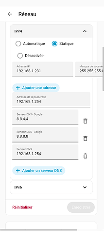

Show your network settings please.
You need to put the public DNS server first, before your router’s DNS server. And then completely restart the router.

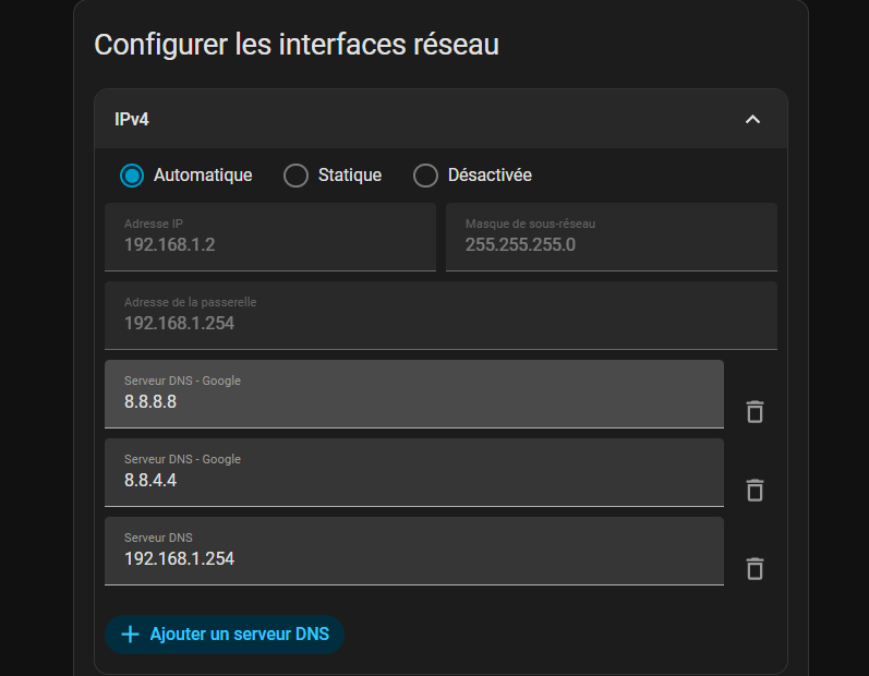

Here the new DNS settings… but even after rebooting still not working :frowning:

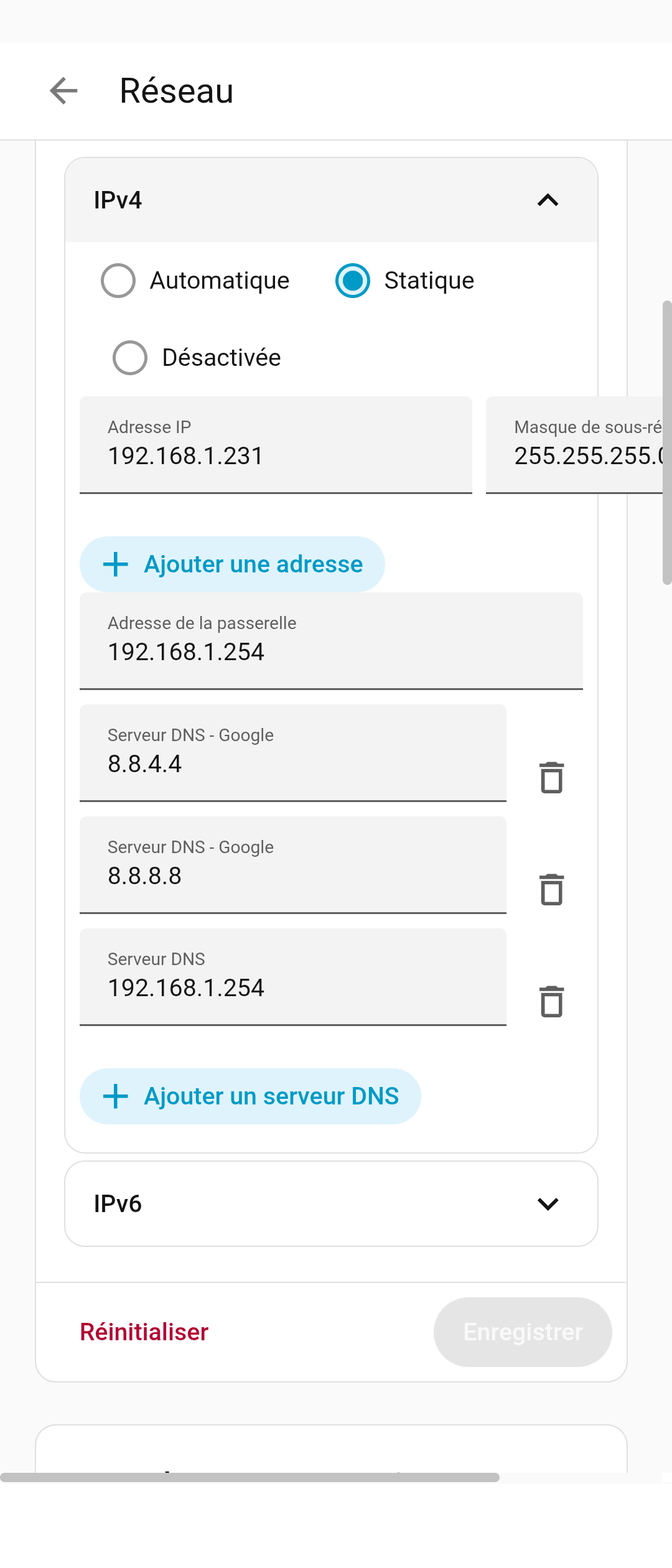

IPv6 is set to auto, and the first two nameservers are Quad9’s.
Inside the core, nslookup resolves files.pythonhosted.org only as IPv6, but wget or ping both fail to resolve or connect.
Edit : 2026.9.2, ISP is Free (but my box is set up to use 8.8.8.8 and 8.8.4.4 anyway).

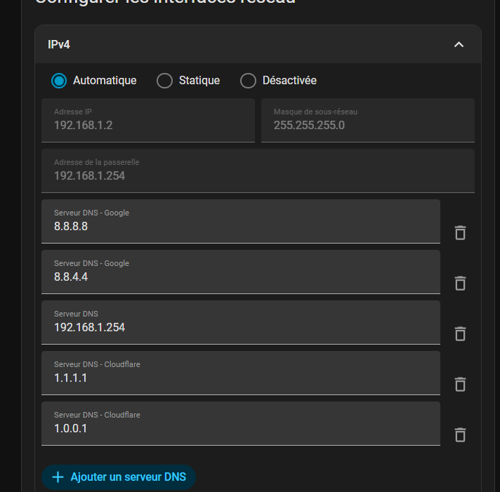

Good news… After also install the cloudflare DNS in the list, it’s working again
