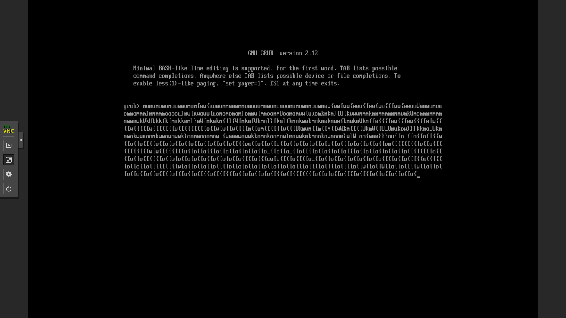

The ports are working, but there’s a problem with HA booting after a reboot.
I have to manually select the system boot option in Grub because the system console is displaying some garbage.
How can I fix this and restore autoboot?
The solution turned out to be very simple. Just changing a single line in /mnt/boot/EFI/BOOT/grub.cfg from set timeout=1 to set timeout=0. This eliminates the waiting time – GRUB immediately boots the system, before data from the port can block it.
