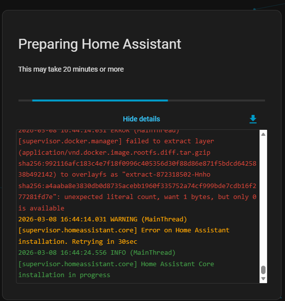

I am having the same issues. I can see the update start and then they never complete and I end up rebooting to get the system running again. This started with another update last month, I can’t remember which one. The progress bar very slowly goes across the screen then it fails, forcing a reboot. It’s almost like there is a network issue but only on their end, all the other updates work. Of course now I have a bunch that won’t load because they require the 2026.3.0 update!

I run “ha docker migrate-storage-driver” and after this my issue was resolved.

Note that Home Assistant OS 17.1 uses Docker Containerd snapshotter by default, optional migration steps for existing installations are available in the 17.0 release notes.

This however sounds like you had issues before, so it might not entirely be depended upon this Release.
This could be “revealed” in a “RAW-Log file” if not a Debug might be needed to further investigate
Which Post ?
You are aware the that “mobile version” showing “snippet” of errors aint of much use ?.
Could you try from a pc/laptop , at home, so your not trying to update OS, or CORE from your Phone-App
This one Corrupt Archive HAOS 17.1 - Installation - Home Assistant Community
I have been using the PC but that is just sat in console and that was the only place i could see whats happening. Ive been trying a complete fresh install with a brand new drive but having no luck on that one either.
