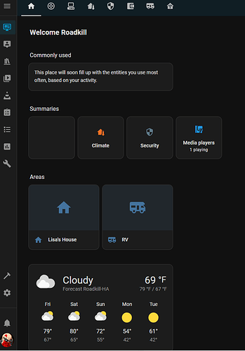

The Summaries card broke with the latest HAOS update.
The lighting icon doesnt display now.
I previously tried to add a new card but the new ones never showed any icons so I removed them because I can not find anywhere that the icon is defined.
Now, I still can’t find where the Lighting icon is defined and it doesnt work like it did before the update.
Does anyone know where this icon is defined?

Thanks for your help!
I had previously tried to define an icon with no luck - Maybe I’m not formatting it right? Not sure but… That didnt work for me.

I don’t remember “Making” this, it was on my dashboard by default I think. I just tried editing what was there by adding new ones - the icons didnt work so I deleted them (keeping the default ones) which coincidentally quit working with just the lighting icon after the last update.
I dont even understand how the others work with no icon defined???

I found the solution: you need to change summary: lights to summary: light.

Also, Thanks for solving it for me… Light worked!
