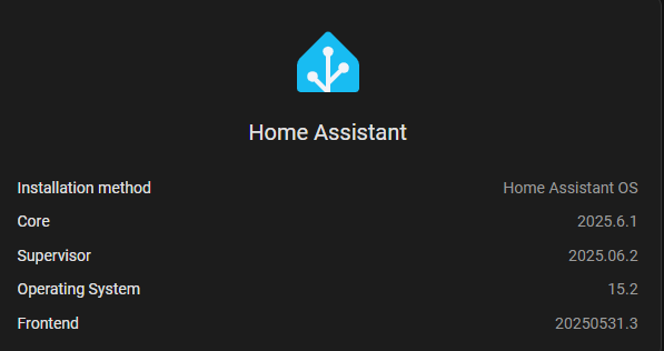

Is it true (and current 2025.6.1 ) that it is not possible to use Google Coral with Frigate?
Intel NUC, HAOS15.2 HA 2025.6.1 (as 2025.6.3 fails for me!)
