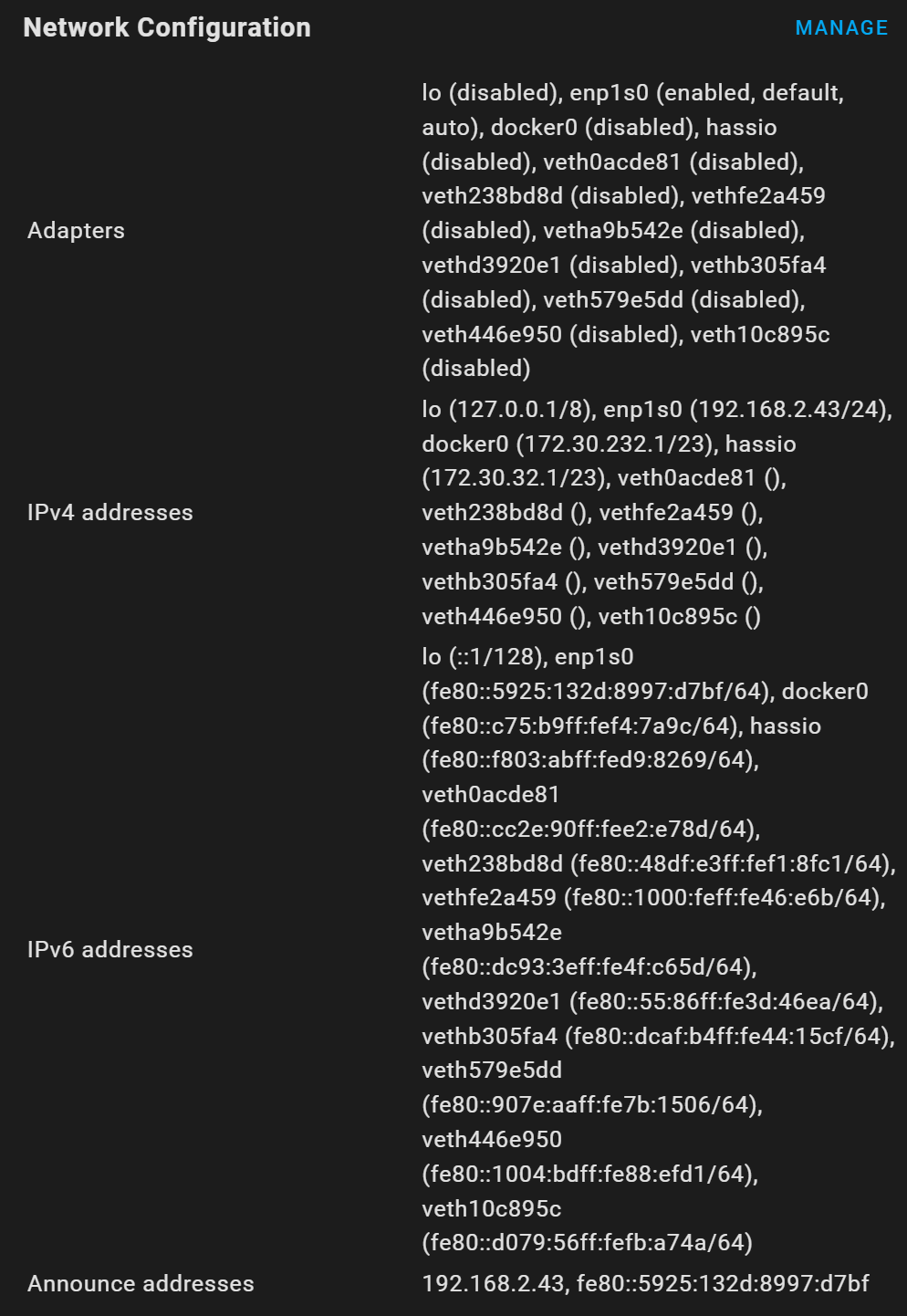

  1. I have IPv6 completely disabled. But in the system information, I see a lot of assigned V6 ips.

IPv6 is disabled in HA, but not in Docker, so other addon/containers might have IPv6 enabled.
But what’s the point of having addresses if the adapters are disabled?
The disabled adapter does not have ipv4 assigned, however it has IPv6 assigned.
And why :
IPv6 addresses: enp1s0 (fe80::5925:132d:8997:d7bf/64)
Announce addresses: 192.168.2.43, fe80::5925:132d:8997:d7bf
Finally: enp1s0 is physical adapter (interface) connected to LAN announces IPv6…
In this case, I don’t understand at all what the “Disable IPv6” option is for.
:roll_eyes:
Fe80 is an auto assigned address for all IPv6 interfaces.
It is used to configure the interface with other settings.
