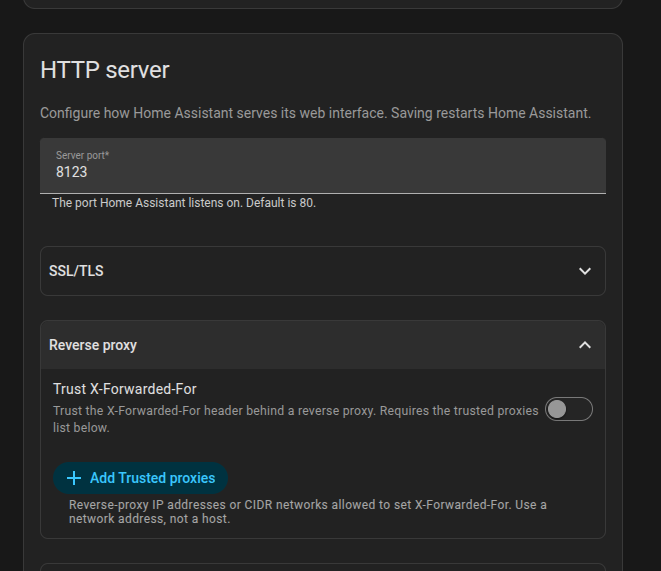

Something like this in your configuration.yaml?
http:
  use_x_forwarded_for: true
  trusted_proxies:
    - 192.168.122.XXX
It’s no longer in configuration.yaml anymore
Sorry for that, was the old version of doing the rev proxy configuration.
Remove the http section from configuration.yaml, before you type in the rev proxy in the GUI.
Settings → System → Network → Reverse Proxy
My problem is that I can’t access anything. I have https://ha.mini.lan proxied to the VM’s IP, the page loads, but the 2 endpoints mentioned fail with 401 and 400 errors. I tried proxying in a way that makes it look like the request isn’t being proxied. Like I mentioned even curl fails on the endpoints with Bad Request response.

Alright, I managed to figure out that HA is running just fine, but on port 80 instead of 8123, because that just redirects to 80.
To access HA in the VM I tunneled my connection via SSH:
ssh -L 0.0.0.0:7123:localhost:80 -p 22222 [email protected] -N
This worked like a charm and I managed to finish the onboarding and set the reverse proxy settings. Now in nginx I proxy to the IP of the guest VM:
proxy_pass http://192.168.122.121;
With that I can access HA via my preferred URL.
