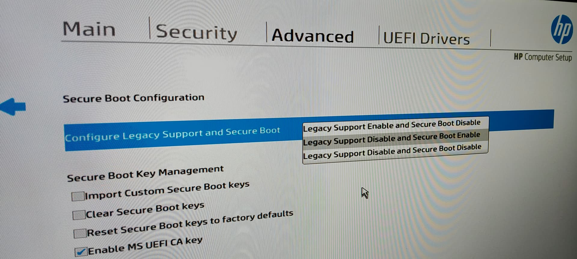

“Selected boot image did not authenticate”
I know I have to enable legacy support and disable secure boot.
My pc seems not to let me save these options. If I set it as I should and then restart and get back to the bios options page, they are back to legacy support disable and secure boot enable.
Any idea of what else I should check/uncheck in the BIOS?

Unfortunately my BIOS has one line for both options
“Legacy Support Disable and Secure Boot Disable” is the option you need to select/ save. Wich translates as UEFI=on, Secure_Boot=off.

I actually tried all of them.
But the main problem is that it seems it doesn’t save the settings, because every time I enter the BIOS after saving and trying to boot, that line is back to “legacy disable - secure enable”

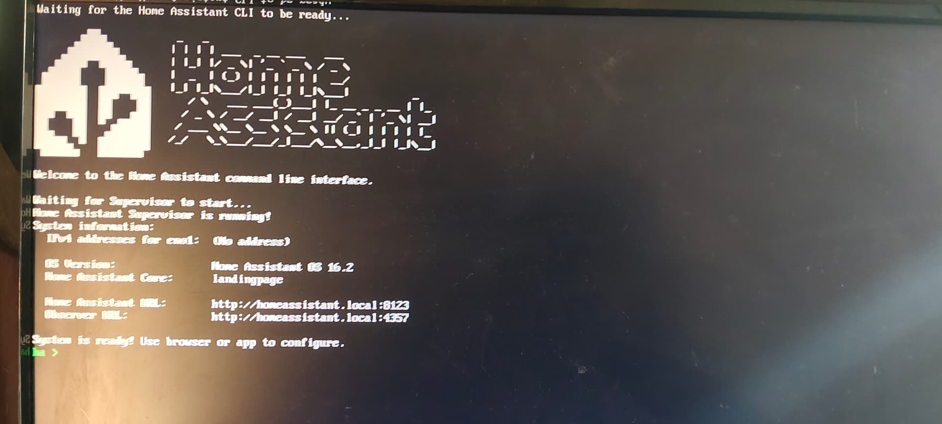

I left it aside for some days, because I had some other stressful things from work to think about, and now I’m back on track! Just saved the settings as legacy disable and secure disable and it’s running!! :joy:
