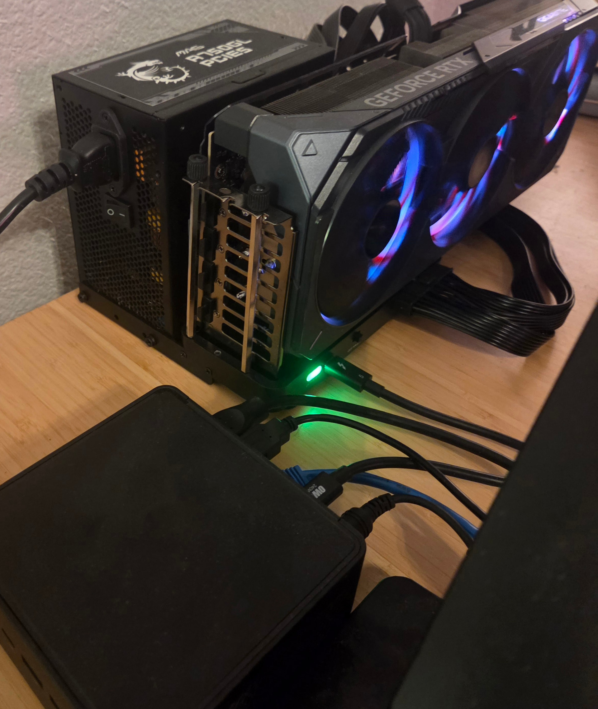

As long as the device you're looking at supports thunderbolt or occulink to hook up an EGPU later it's fine.
(that's a 5070ti mated to an Intel NUC14ai through thunderbolt, and what Friday runs in)

Yousaf was talking about buying a mini PC and in hindsight my recommendation if he is thinking of AI in the future, is to go for one in a desktop or tower case that has space for a full-sized video card ... much easier to add a video card later. I am sure that Nathan wouldn't have mentioned the EGPU if it wasn't acceptable - but to me having it as an add-on looks awkward and more expensive.
