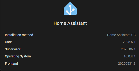

I am running HAOS 2025.6.1 with Operating System 16.0.rc1, it randomly shuts down without any warning

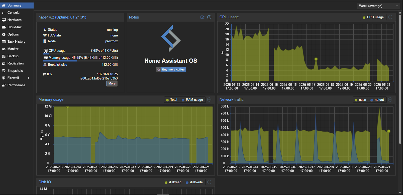

Host logs between shutdown and manual start after 4 hours
025-06-21 19:10:53.887 homeassistant systemd[1]: Started Time & Date Service.
2025-06-21 19:11:23.659 homeassistant systemd[1]: systemd-hostnamed.service: Deactivated successfully.
2025-06-21 19:11:23.935 homeassistant systemd[1]: systemd-timedated.service: Deactivated successfully.
2025-06-22 03:21:43.050 homeassistant kernel: Linux version 6.12.33-haos (builder@280a9cb85da3) (x86_64-buildroot-linux-gnu-gcc.br_real (Buildroot -g30ef1047) 13.3.0, GNU ld (GNU Binutils) 2.43.1) #1 SMP PREEMPT_DYNAMIC Mon Jun 16 09:52:35 UTC 2025
both times are wrong.

Make an issue on HA OS Github, and revert to HA OS 15.2
It also broke ADS-B Multi-Portal Feeder add-on
