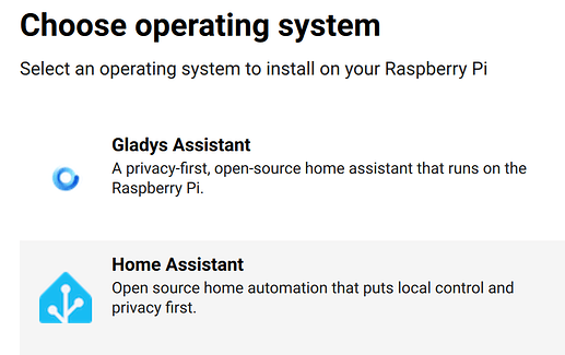

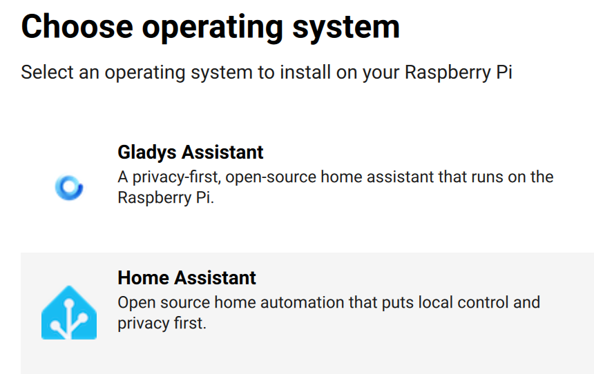

Did you install Home Assistant?
Choose Operating System → Other specific-purpose OS → Home Automation → Home Assistant:
Note that it is homeassistant.local not :local.
