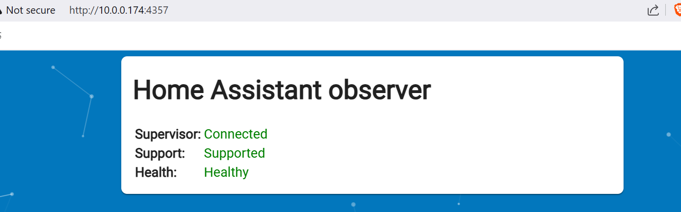

Home Assistant Observer started responded after a supervisor reset. http://10.0.0.174:4357/ connects fine,

But what you say about installing makes some sense as at first the observer page wouldn’t respond either but does now.
