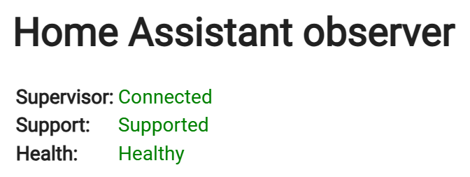

Thanks for your help. All statuses are reporting green on the Observer.
I downloaded a partial log whilst it was "preparing", there is no reference to an error or container:

EDIT: I tried to find the thread you mentioned but no success (I searched for similar terms; and browsed through the Installation posts back to the start of April). The only relevant reference I could find was specific to Home Assistant Green.
I think my next step is to try imaging the USB drive direct from the old SD card, which sounds unlikely to work but I think I saw a tutorial somewhere.
Update: I restarted a third time, and this time it loaded HAOS, and allowed me to select apps as part of the restore, so I'm now up and running on the new USB drive.
In case someone else has the same issue, it appears that there is no visual indication in the error log or UI of it running in container mode, other than the fact that you can't restore apps from backup. I didn't do anything different each time I rebooted, so suggest you try several times, powering down manually each time (as there doesn't seem to be a "power off" option on the Onboarding pages).
