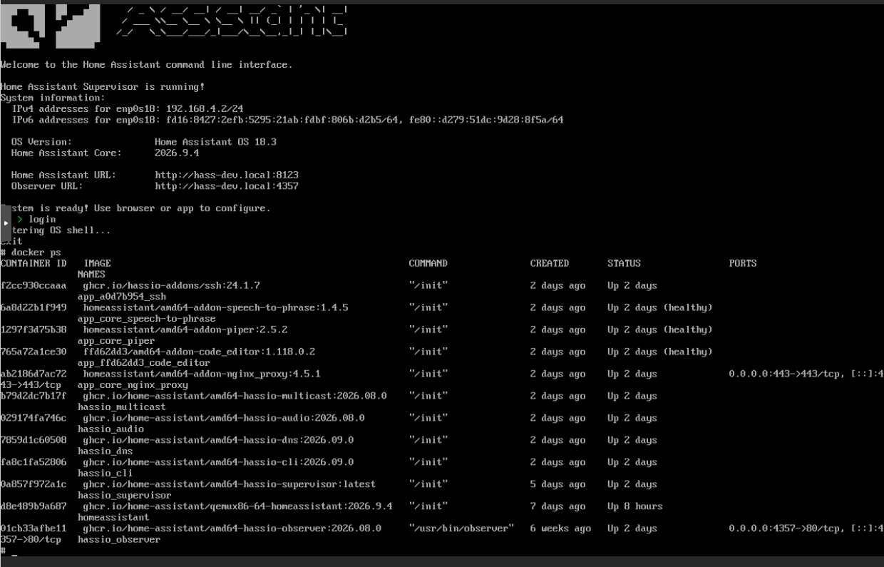

From where (or how) did you issue this command? This might not be an available command on HAOS.

Man, I don’t know what are you trying to tell me. I am running HAOS in a VM. That’s it. And that system (HAOS) is using docker (under-the-hood) whether I need to know that or not. And yes installing Apps/Add-on (whatever) is creating more containers. My point is that my system stopped working reliably and the troubleshooting led me inside (under the hood) and I noticed that docker is unresponsive.
From my VM shell.

There is no docker ps command in HAOS, and you cannot get one – apt-get is not a thing either. There is supervisor info and supervisor stats you can run from shell, but not the same.
SG is trying to see what kind of install you have - because you talked about docker ps (among other things) as if you have done so before in your install, and he also know there is no such thing as docker ps, so it is (or was) confusing… based on the initial information you have provided… hence this question trying to seek clarifications:
I think I never said I ran docker ps inside HAOS. I was running the command in the VM shell that is running HAOS. I even clarified that later. I didn’t mean anything I wrote above to be rude and if it came of that way I sincerely apologize.
