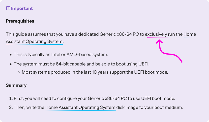

The machine you run HAOS on has to be dedicated to only HAOS. No other software.
https://www.home-assistant.io/installation/generic-x86-64
yes done all that followed all instructions in HO managed to get ubuntu installed then tried to install through this it following guild but came up with error when trying to install latest. Problem mounting boot medium i think sector (0-0) came up.
