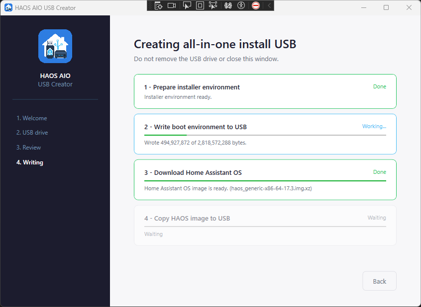

The goal is to make installing Home Assistant OS on a dedicated generic x86-64 PC a bit more straightforward, especially for users who do not want to manually download the HAOS image, use a Ubuntu live USB and write the image manually.
The basic idea is:

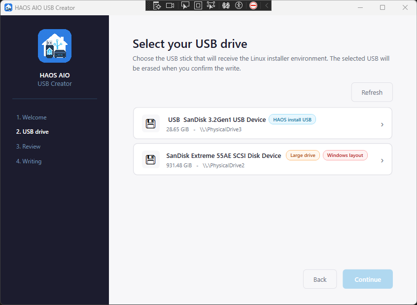

  1. Run the Windows app.
  2. Select a USB drive.
  3. The app creates a bootable HAOS installer USB.(Alpine Linux based)
  4. The app downloads the latest Home Assistant OS generic x86-64 image and copies it to the USB. (it will also keep a copy on the PC for future use)
  5. Boot the target PC from the USB.
  6. The Linux installer checks for online for updates.
  7. Select the internal disk to install HAOS to.
  8. The installer writes the official HAOS generic x86-64 image to that disk.
  9. Reboot into Home Assistant OS.

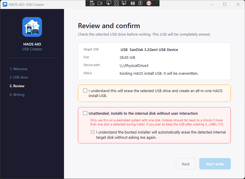

There is a unattended mode which will automatic write to the disk, install will fail if there is multi and to protect from install loops will try to set efi to next boot, also a file is place on USB to catch it just incase (only effect new installs)

Yes, if you check unattended install it will do a full install without a monitor
The one caveat is that it will only do a unattended install if there is only one internal drive in the system

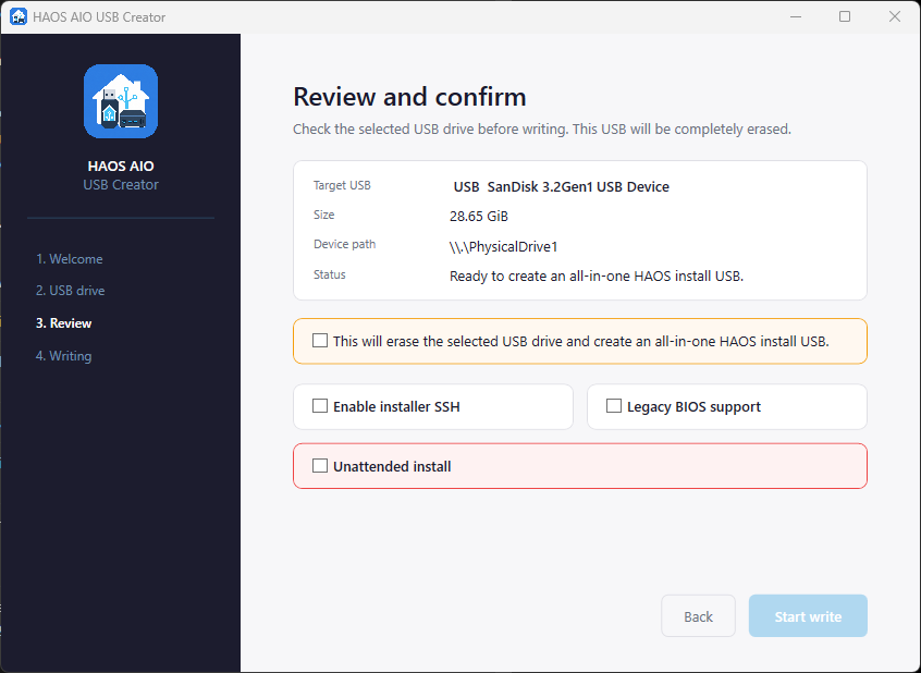

For a headless install, the intended to use the unattended option in the Windows USB creator. That writes the installer configuration to the USB and the booted installer should proceed without prompts and ONLY if it detects one internal disk. In that mode, network is still optional since the HAOS image is already on the USB. The attended install was not designed for SSH as it expects user input before it ever reaches the network check or DHCP attempt.
unfortunately if you can't use unattended because you have more than one internal disk then this is not going to work. I will look into enabling headless SSH installs in a next release.
