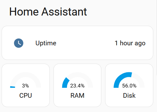

I found that music assistant ate most of my RAM
As cooljimy84 says, Linux, in this case Linux in HAOS, will cache stuff in ram, but still see it as available, because cached stuff can just be ditched quickly.
For the Hypervisor (Proxmox, which is also running Linux) it looks like all the ram is used, because Proxmox can only see the ram used, not if it is for active data or for cached data. It is just data.
If you want to monitor ram, then do it inside the VM.
