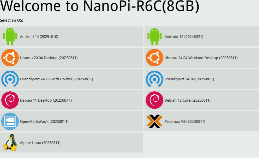

I can install these OSes on my host:
What should I try next?

Solved:
  1. Used Ubuntu 20.04.06
  2. Got virt-manager installed and working.
  • This was the hardest. A few issues related to ARM64, but finally google searches helped me fix the problems
  1. Used HAOS Linix install with qcow2 file
Thanks for the advise.
Small correction:
Used this file haos_generic-aarch64-16.3.qcow2.xz
