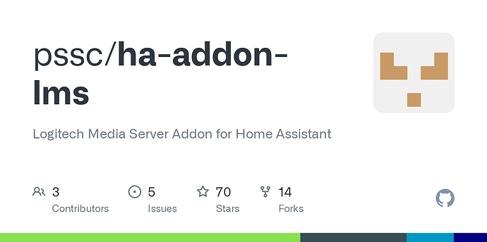

Just remembered something: before I got the new NUC I had installed Lyrion music server, hadn’t but I am guessing a music server would be not possible with HAOS ?
I’m all set then !
