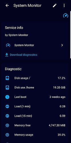

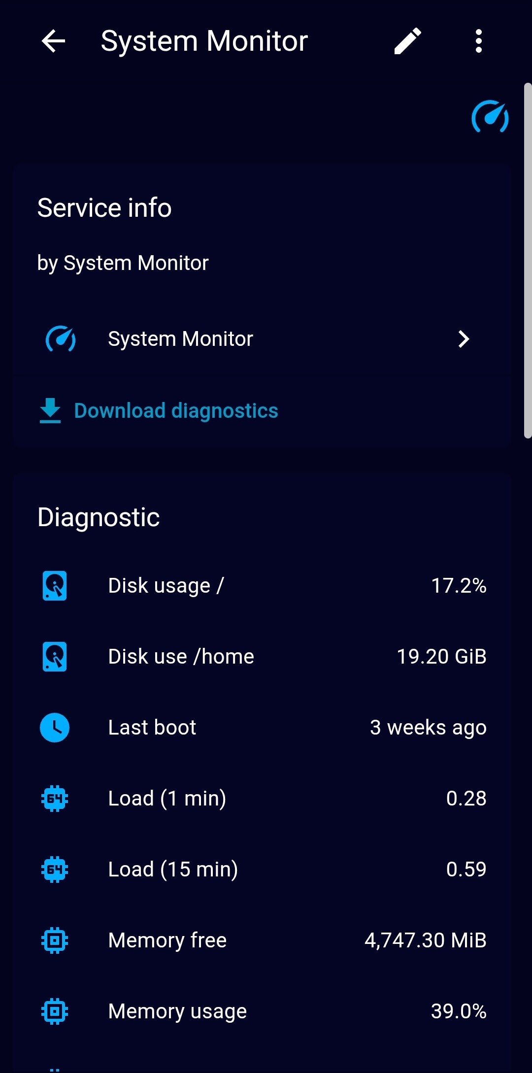

It might help if you could name the hard ware like how much memory. List the apps/integrations running. Keep an eye on the system monitor to see where memory and cpu,temp are just before it goes down
