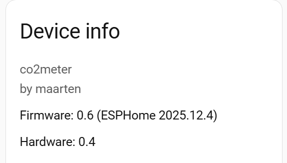

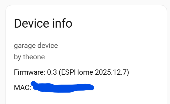

In the home assistant devices dashboard is the hardware version missing on all my recent and new created devices. The older devices have a hardware version number (see pictures).
The home assistant source coude __init__.py states that hw_version = device_info.project_version however it remains empty.
I can also check this with the jinja template
{{ device_attr( 'light.garage_status_light', "hw_version") }}  result = No

An older device (added somewhere in 2022 or 2023) does have the hardware version! And now changing the device.version in the esphome yaml doesn’t update this tag but it does update the firmware version.
I don’t get it why some (long time ago added) devices do have the hardware version and the newly added don’t.
The same behaviour happens on another install.
So is this a home assistant bug? Other people with the same problem?

This isnt a sensor or entity and therefore cannot be enable or disabled. This is the information from the device - see the screenshot.
Does anyone else have the hardware tag in their device information when adding a new device?
