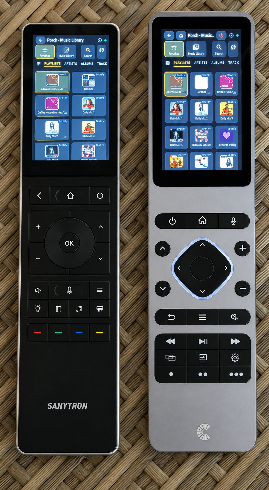

Hardware: any browser is a remote — a wall tablet, an old phone, a spare laptop tab. My daily driver is the Astrion (~$180, stock Android, real buttons) and a Haptique RS90; @thebradleysanders excellent sideloading guide gets you from box to Fully Kiosk, and there’s a dedicated Astrion thread over on the Sanytron forum. One caution from my own bench: skip the guide’s “install the HA Companion app” step — a background wake lock kept my unit from ever deep-sleeping, and Harmonium doesn’t need it.

This looks great. From your testing so far can you advise which remote will work best (most reliable/responsive) with this? The Sanytron Astrion or the Haptique RS90.

Great question. Gimme a few days to answer that. I only got the RS90 up and running a day or so ago.
Over the next few days I’ll do an A-B. Especially on things like battery life off the cradle.

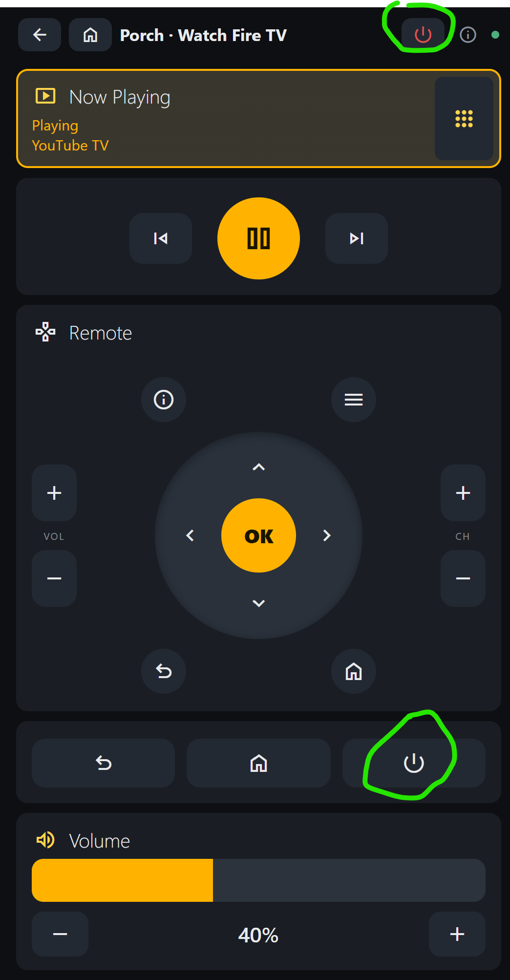

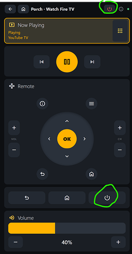

  • Sometimes the power off button on the room page disappears, even if an activity is still active. Couldn’t figure out yet how to reproduce it, or if it’s current missing, how to get it back.

Could you explain #2 (change activity), with a use case and #3 (power button) [im guessing you mean in a browser? - but which power button? Maybe you can take a screenshot.

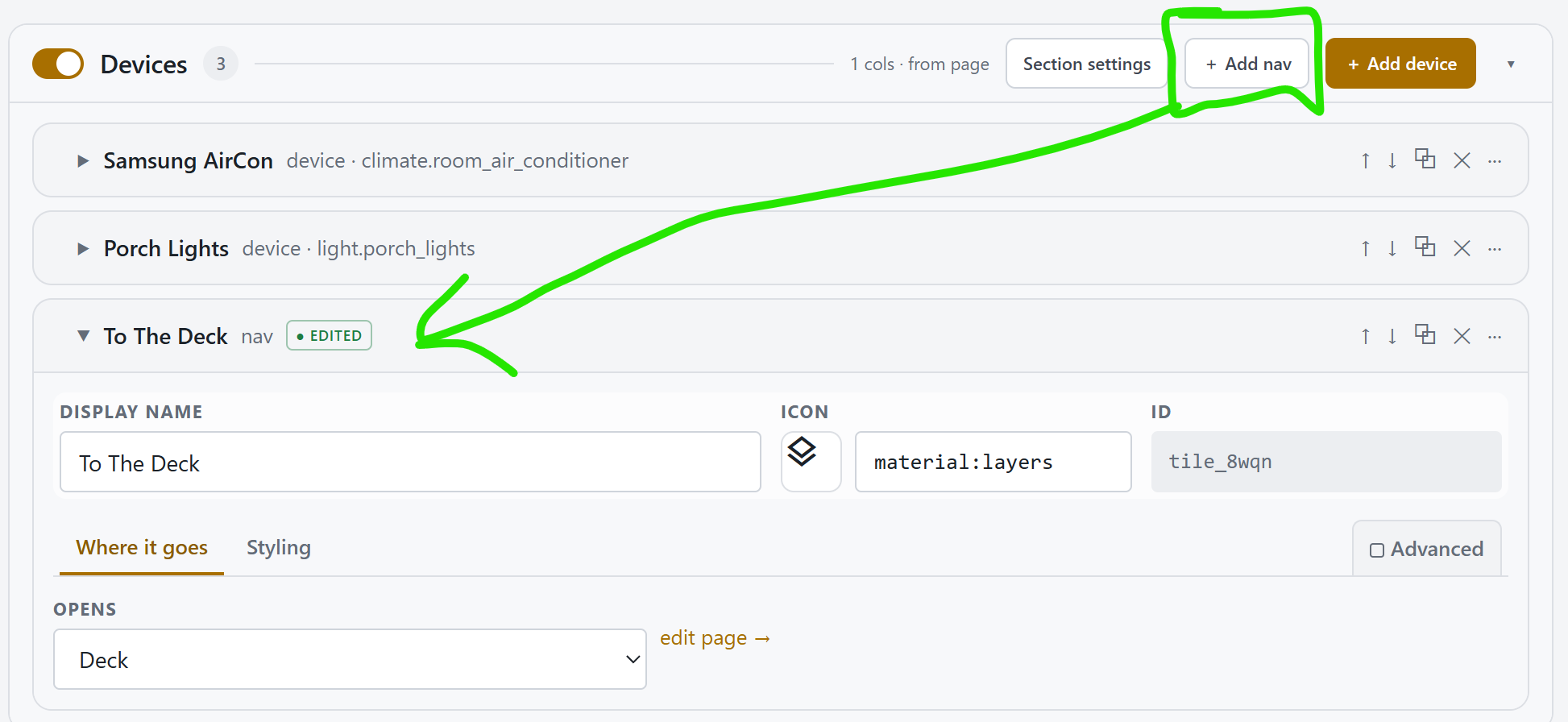

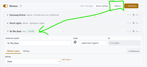

A little side question: Is there a way how I can open subpages by URL, e.g., by specifying a HTTP GET parameter? I have a main page that links to the different rooms. Since I am using the UI in a browser, this would help to directly jump to the room page. The only option that I found was to use separate workspaces to implement this.
If you mean a tile that takes you to another page, it’s already there. See below.
There’s also the concept of a true home page. If you mean link to a page from the outside, you’ll have it before the day is out!
