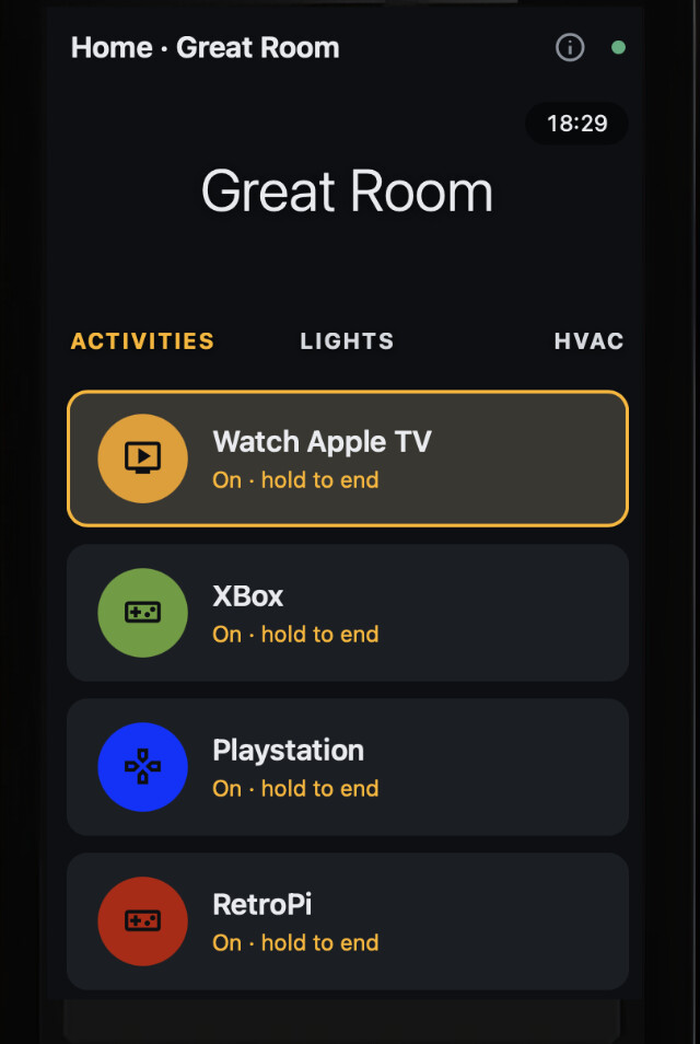

I’d LOVE to see some screenshots of your setup. To inspire me and others!
Is AppleTV working for you?

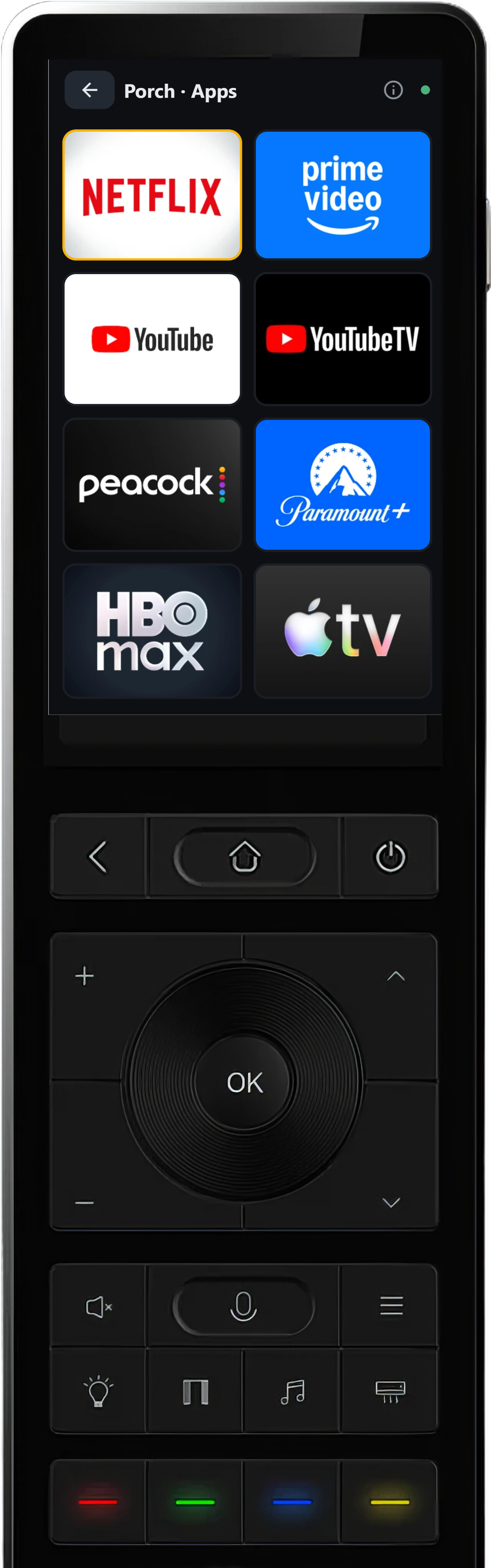

Meanwhile next up on my end!

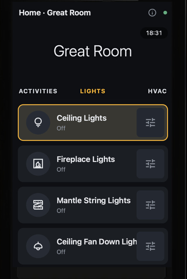

Sure thing, here are a few of where I stand so far. That app selection looks great!
Thats awesome. Is AppleTV, XBOX and playstation working?
Apple TV is definitely working. I don’t have the XBOX or PlayStation integrated with Home Assistant, so I wouldn’t be able to drive them from the remote. Maybe I’ll try that out though for the sake of completeness.

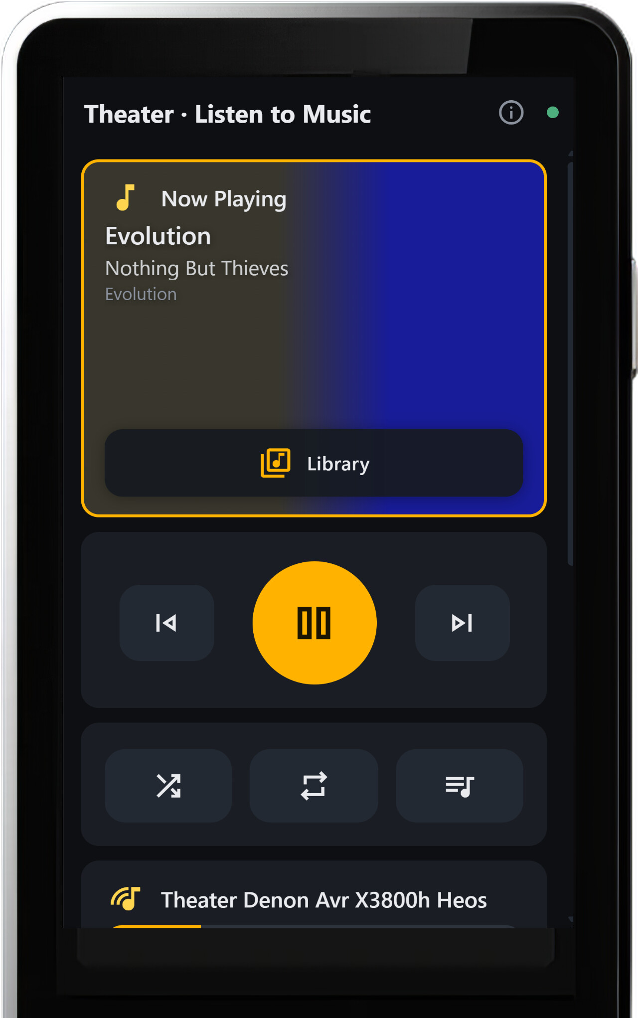

Screenshots
As requested, I included some screenshots of my setup. Just one page so far. I’m planning to add some presets that allow me to add a 2nd zone audio, make changes to the TV picture setting (movie vs TV) and keep iterating on the app library and media player availability (Plex, other music apps, etc).

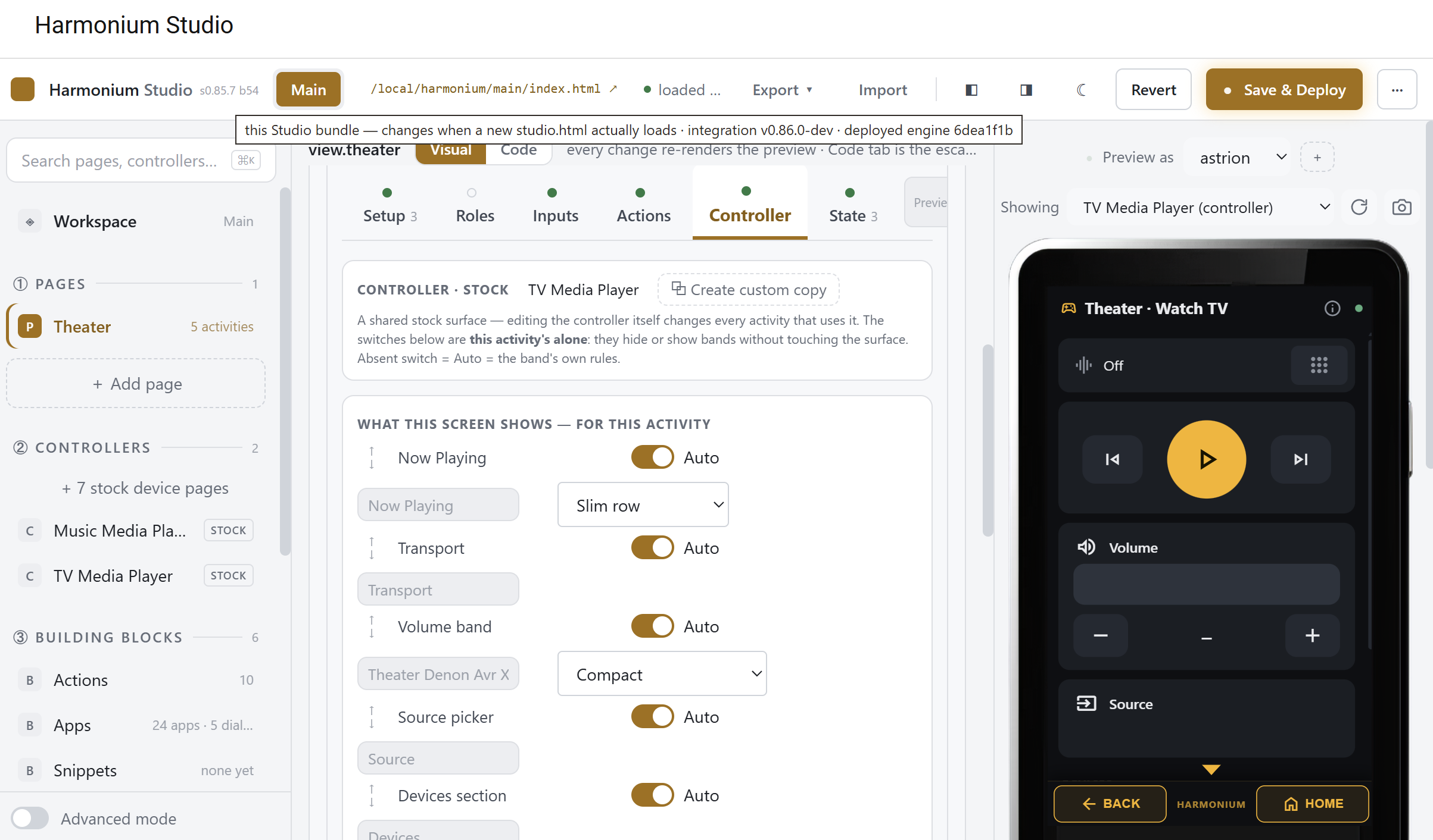

My only real persistent bug now is an issue where I can’t get the Volume Band in either the Music or TV Media Player to change type anymore (I’m stuck on the theme default or “fat” one). I could have sworn I could do it earlier today, so maybe it’s some issue with my configurations since. OK if I start a new issue on GitHub with the documentation?
Let me know if you want me to record any of the others as issues to keep discussion in this thread clean. Thank you again for your hard work, and it is impressive how quickly you’ve iterated on this!

**Volume band stuck on the fat one — your bug, confirmed and fixed.** The Controller tab’s Volume style dropdown sets the activity *default*, and a per-row :gear: style or per-member volume option silently outranked it — which is exactly the state you were in. In 0.86.0 the overrides are listed right beside the dropdown (“:gear: pinned: …”), each with a one-tap ↺ to clear. No need for the GitHub issue unless you’d like to confirm the fix.

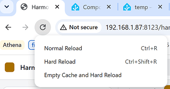

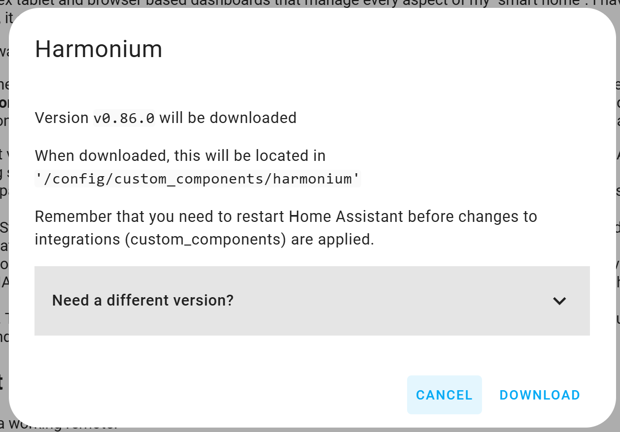

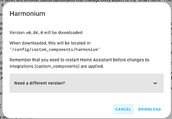

I went through the upgrade, but I can’t seem to load the new version of Harmonium Studio (and none of the new features are available). I rebooted HA, and also removed and re-added the service and I seem to still be stuck on 0.85.7 for the Studio page. Integration backing it is up-to-date.
Weird.

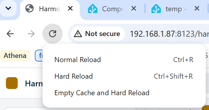

I presume you hard refreshed the browser (i.e. F12 for dev tools, right click on refresh and Empty Cache and Hard Reload).
And when you go to HACS, and click on Harmonium, it says v0.86.0?
and when you downloaded it it said v0.86.0?
Let me know those answers and I’ll start scratching my head!
s.
That fixed it. Hard refresh wasn’t enough, the empty cache did the trick, thanks.

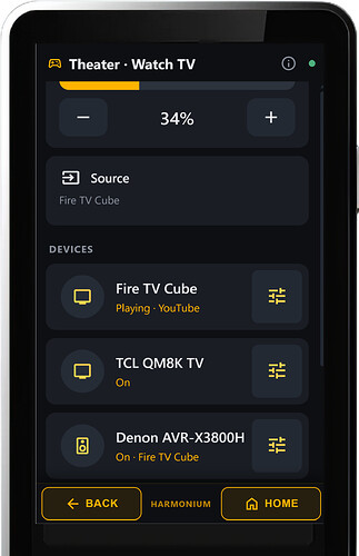

The available functions in the device controller view from the activity’s cast is limited to a few functions. If we could define what we could use in those device pages (or just activate all the roles of the pre-wired device), it would allow you to quickly change settings in the individual device (and keeps you from having to fish out the old remote).
Design:
Given you are in an active activity, and you select one of the devices in the cast from the activity, then the functions of the remote change to the roles of the pre-wired device (not the activity) until returning to the activity page.
Example:
My Watch TV activity gives the D-Pad role to a Fire TV and the volume role to an AVR and no roles to the Sony TV, but if I click on the Sony TV from the cast, all roles switch to the Sony TV and I can use the button map (physical remote or phone) for the D-pad and the volume on the Sony TV.

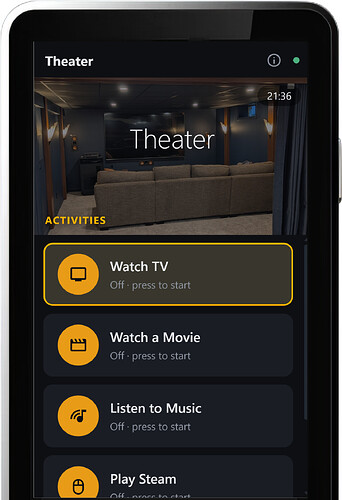

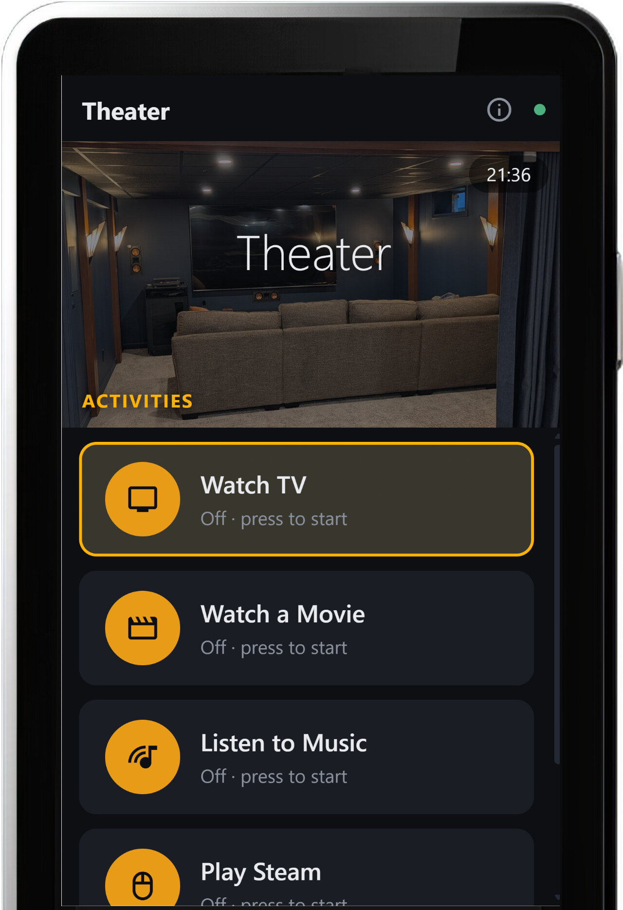

You asked, you shall receive.
Maybe tomorrow. Working through testing. It was 80% there - adding some polish…
0.87 will be a pretty big release and will need some heavy duty testing in the field.
Sneak peek:
