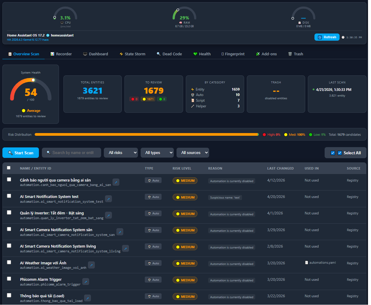

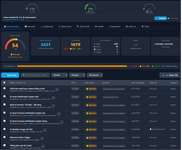

I’m wondering if anyone has any experience with the custom integration HA-Optimizer.
It looks and sounds very promising.
