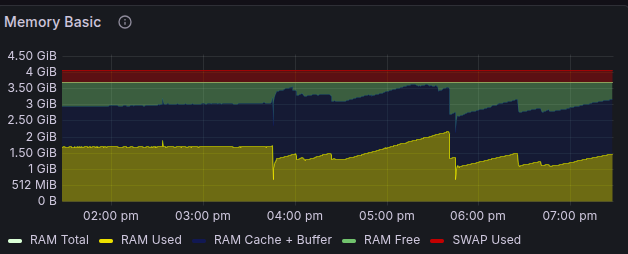

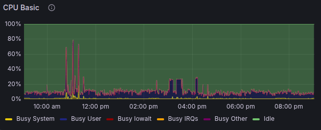

I updated from 2026.2.3 to 2026.3.2 today (docker) and noticed the frontend was struggling every now and again and has a few moments where all MQTT devices when to unknown and then “restarted” a few moments latter.
Checked Node Exporter data and it looks like a memory leak.
You can see that 2026.3.2 was installed at around 11am and then i reverted back to 2026.2.3 just after 4pm and the memory leak disappeared.
The HACS (and all other) integrations stayed the same (no updates) and nothing else changed between the revert, it was a direct update of the docker compose. I didn’t find any obvious errors in the logs.

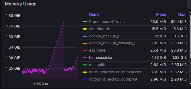

I am using Docker and not Home Assistant OS so the AddOn memory monitoring won’t help. I do know it is the python3 -m homeassistant --config /config process that was using the most memory.

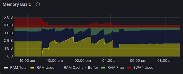

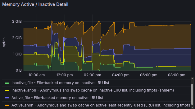

I updated to 2026.3.2 again at 15:50, still had a leak. Then i restarted in Safe Mode at 17:45, the max memory footprint is much lower but there is still clearly a leak somewhere:
