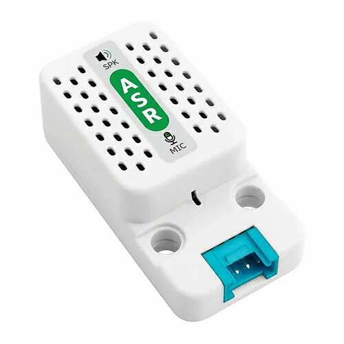

Has anyone tried the M5Stack ASR Unit with Assist?
Any thoughts on whether this component will work?
We have the HA Preview Edition retailing at £56 in the UK so if the M5Stack at £7.50 will do the job that will be a much more economic option if I’m looking at having 5 units.
Thanks for all advice.
Hi, does this device have any advantages compared to using an Atom Echo which is supported?
The M5Stack ASR looks like it might have more internal voice processing (PS I’m not technical, I am just reading the description notes!), and costs less than the Atom Echo. It would be nice if if did work satisfactorily.
The product comes pre-configured with 42 English wake-up words and feedback command words.
Totally useless for the Home Assistant.
That was my idea as well but wanted to be sure.
I even wonder if you can get it working anyway.
