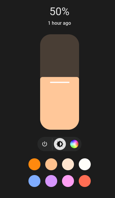

Has anyone used an addressable WWA / CCT led strip?
I have some LED strips with 5V SK6812 type LEDs, but instead of RGB colours, they have Cold White, Warm White and Amber LEDs. Although this works with Adaptive Lighting mapping CW to blue, WW to green and A to red, it is kind of awkward when HA shows you a colour palette as a control.
Is there any implementation of this type of light in HA / ESPHome? Or am I just nog looking for the right naming?

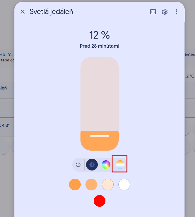

You can always use the temperature control…
Except I cannot
