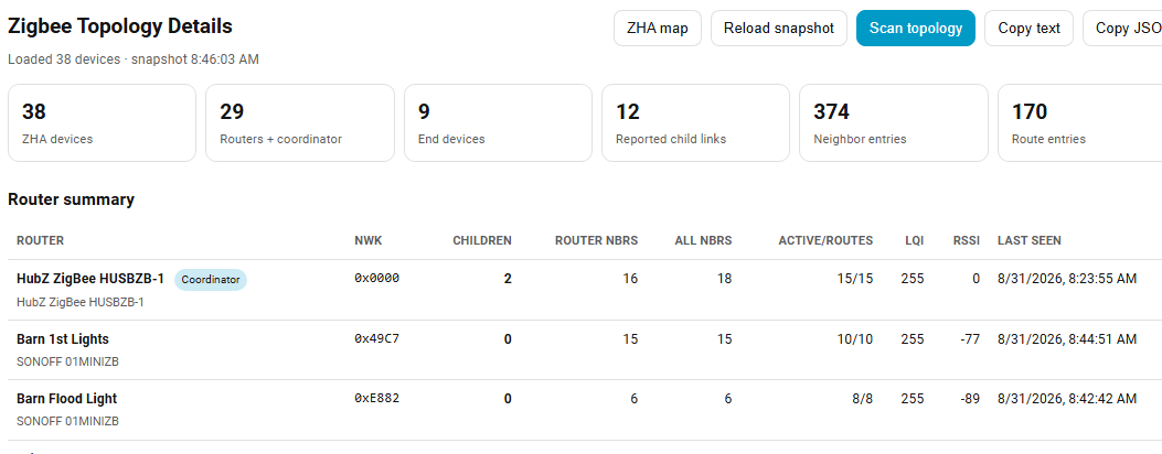

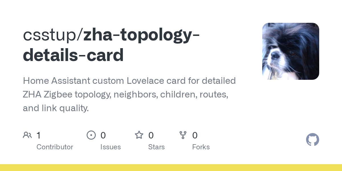

If it would help you, I had developed this tool to help me see what my ZHA mesh was actually doing, I went ahead and uploaded it to Github as a HACS dashboard repo, or you can install it manually.
It shows an expandable summary of all your routing devices, their neighbor and router tables, and more.
LMK if you get it installed and it works for you!

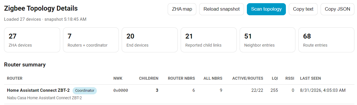

I just installed this (manual install).
Love it, thanks!!
Awesome, glad it helped! If you don’t mind, share some of your routing details, I’m curious how it looks on other systems.

Here are first few lines of mine. I do have one suggestion, and that is to add the ability to sort by tapping/clicking on the column headings.

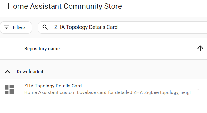

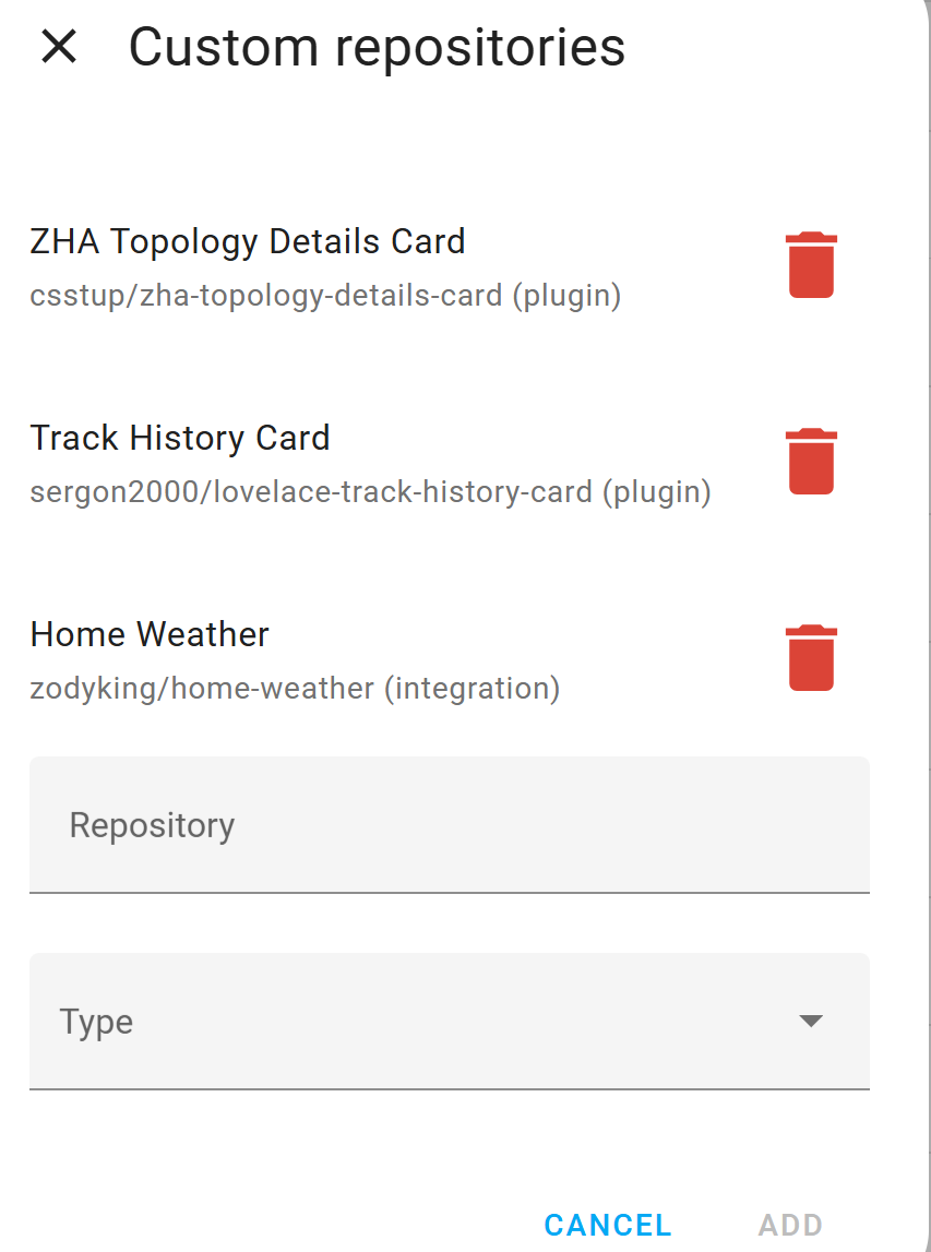

I think that I have successfully added the card but don’t see it when I try to add it to my Dashboard:
After adding the repo, install it by searching for the name in HACS, then add it by clicking the row:
then click INSTALL at the bottom.
I updated the README in the repo to hopefully make it more clear.
That did. Thanks !!!

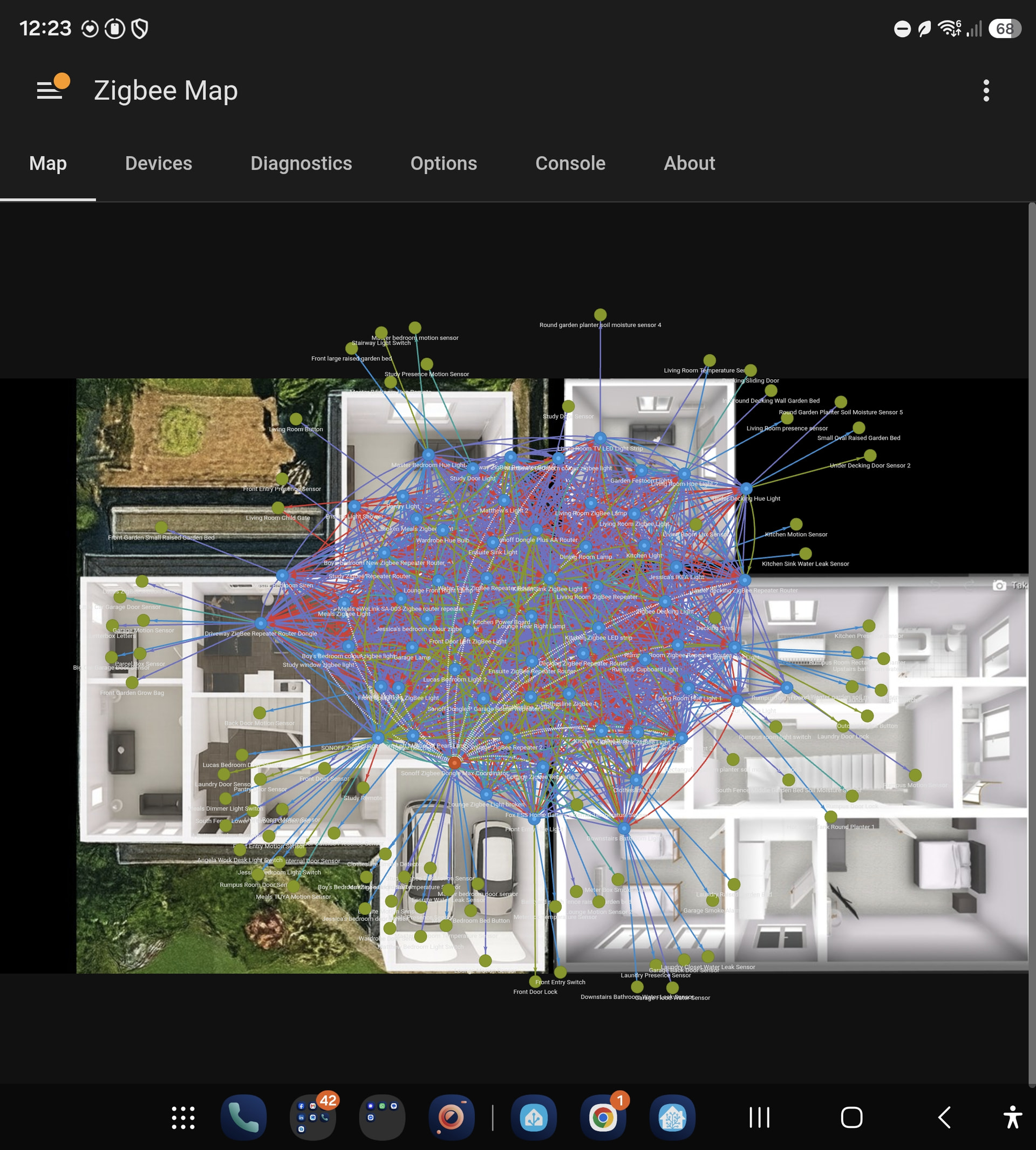

Thanks for sharing. I have been using dan-danache/ha-zigbee-map: Real-time visualization of your Zigbee mesh network - Codeberg.org but visualisation of 160 devices in a mesh topology is a pretty map of busy lines even though I did overlay on my floorplan.
I’ll take a look at your work and see if it helps.
The last update broke the placement of all my devices and I haven’t set aside time to redo them yet.
But here’s what my network mesh looks like
And a simpler view of just my dedicated routers
Let me know if there is any information that might help debug your situation or some workflow I can add.
Have you reviewed the ā€˜Console’ log after you run a mapping in @dandanache Zigbee Map ? Look for any of the ā€˜Anomaly detected’ entries and go thru and remove and re add (one at a time) each device that shows that they are retaining any orphaned devices. It may take you several evolutions of this to find these, over several days. Cleaning out these seems to significantly, however not completely, improve the occurrence of devices that drop off for a period of time and then return. However, still not a complete fix for latency of devices responding to commands. It is interesting and frustrating that a Zigbee device will retain the address (for what purpose I do not know) of another device that is removed from the network, basically forever (until you ā€˜clean’ the ā€˜retaining’ device by removing and re-adding). Seems a real design flaw in Zigbee networking.
I will qualify my point, I do not see you stating whether you are using ZHA or Zigbee2MQTT. I am using Zigbee2MQTT, so I do not know if @dandanache 's utility generates this diagnostics message for ZHA.
Good hunting!
