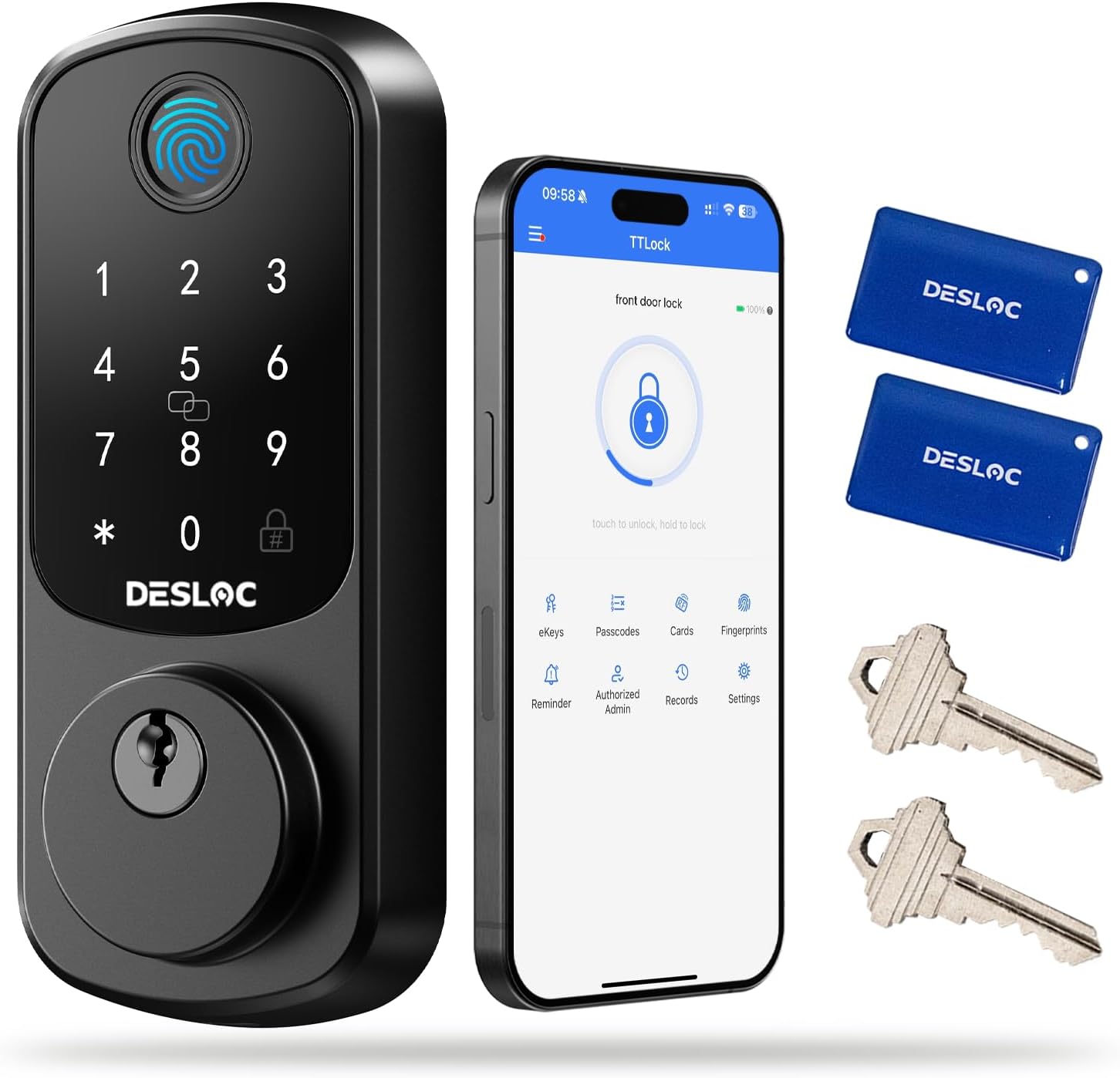

This is a great project, and I was hoping to have a working offline TTLock add on. After trying everything discussed here and more to get it working I ended up hiring a specialist developer. Now I have an updated and working Bluetooth gateway. We are in process of fixing some TTlock addon Bluetooth issues. Soon we expect to have a working and supported TTLock offline addon release for one of the top selling TTlock models;
DESLOC Smart Lock B200
We are considering supporting other popular TTLock models and providing prebuilt images of the updated and tested version of this gateway (eliminating having to buy the official TTLock gateway used with a TTLock Bluetooth lock)
In order to continue maintaining this addon and provide some level of support the prebuild image will be made available for purchase for around $30 USD (in the price range of the TTLock gateway that will not be needed). The updated and tested version of the offline addon will likely be included at no additional cost.
I’d appreciate if whoever is interested in supporting this effort and like to down the working prebuild image mentioned to let me know.
