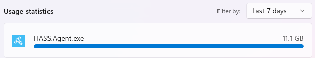

I’ve just noticed there has been a LOT of data usage from HASS.Agent (2.1.1 of the amadeo-alex fork).
Does anyone have an idea what could have caused this?
I have it installed and configured but am not really using it much yet, haven’t yet installed the HACS integration, so this seems pretty weird. This is a PC that has not been used for a little while (with the agent installed a couple of months ago), and then used a fair amount over the last couple of days, but that doesn’t really explain it.

I just came here because of the data usage. 45GB for 30 days and 11GB for 7 days. I have version 2022.14.0 so it does not seem like the forked version is the problem. This is a crazy amount of data.

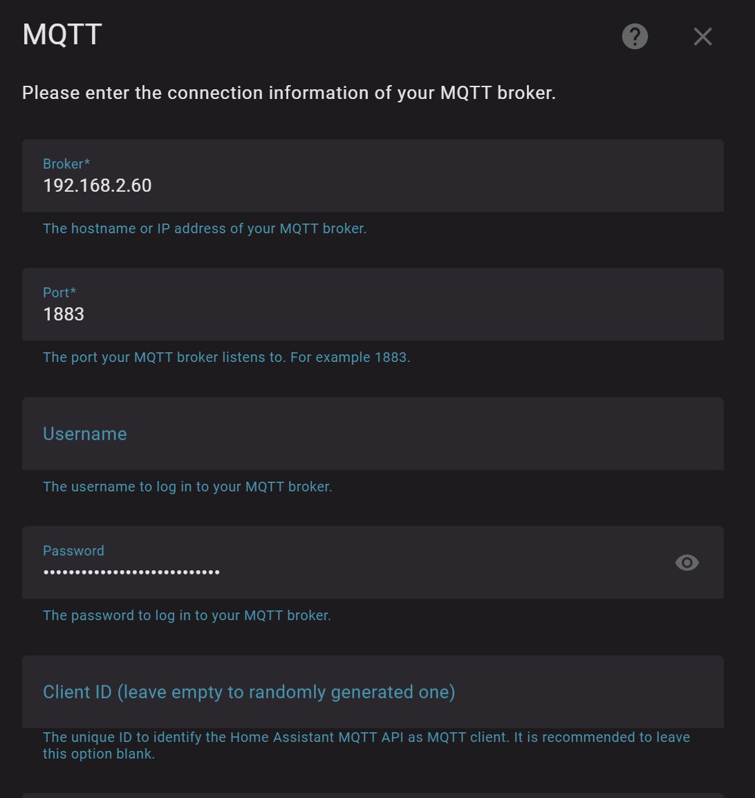

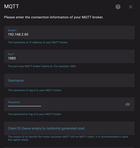

ISO MQTT connection help… I have installed this on a few PCs, none of them connect to HA’s native/default MQTT… but I know MQTT is working since its brokers Z2M. I’m using the default install, default user/pw
thx for the help!
Does this app no longer work with HA MQTT?
The app works with MQTT for me.
However, I don’t believe the screenshot you posted is from HASSAgent, perhaps the HA MQTT integration?
In any case you’ll need to troubleshoot MQTT. Yo could try to connect to your MQTT server with MQTT Explorer. You would see any service you’ve configured making it’s updates to the topics. If you can’t login you’ll have to figure out your authentication.
Can’t help much more than that without more info like logs, config, etc.
that screenshot is HA’s MQTT… I was showing that its setup, and working. The HASS Agent is not connecting to it.

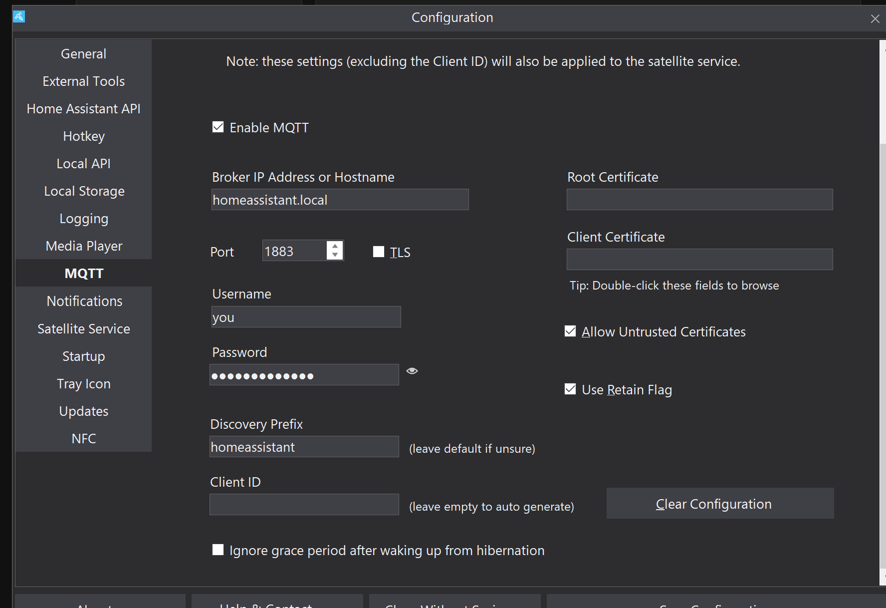

It may be helpful to share your HASS.Agent config. Something like this…
thx, I didnt realize until after I posted for help that the broker is what it needed to connect to, not the HA server’s MQTT client… the default is in the UI has homeassistant.local and my brain did’t register that it needed the Broker.
its connected now, again thank you
