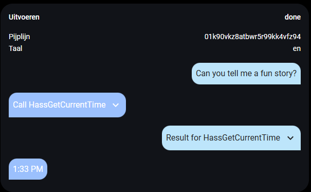

Wow this looks great! For me, the internall fuzzy matching is too strong to start with. I get these weird responses for example:
I will give it a try to see if it improves the intent matching!
