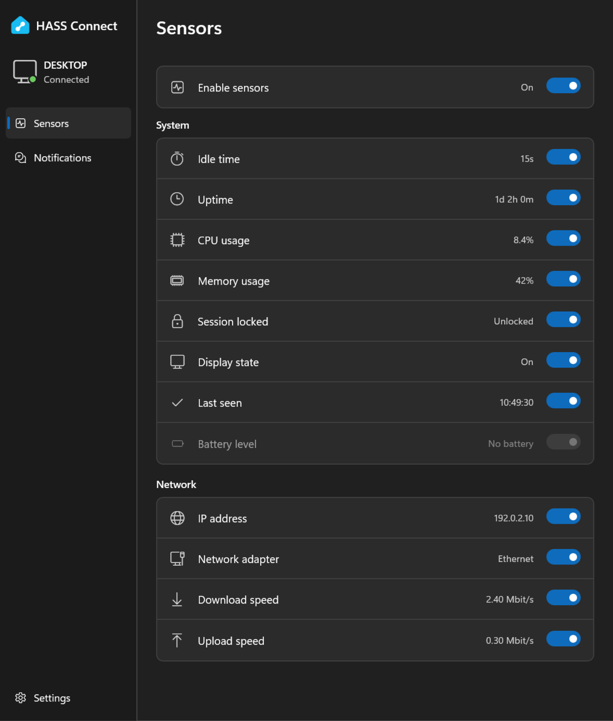

I wanted a small Windows tray app that could report PC sensors to Home Assistant and show notifications. A clean Windows 11 UI, without another broker to configure. So I made HASS Connect.
Sensors: CPU and memory usage, idle time, uptime, session lock, display state, battery level, last seen, local IP, network adapter and upload/download speed. Everything is off by default, so you choose what gets reported.
It uses Home Assistant’s built-in Mobile App integration. Despite the name, it provides the sensor registration and notification support a desktop app needs. Enter your HA address and an access token, and it creates a device and a notify.mobile_app_... action. No MQTT broker or custom integration required.
Notifications support camera snapshots, buttons that return events to HA, dashboard links, and replacing or clearing alerts by tag.
