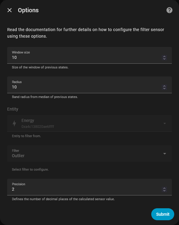

I’m trying to filter an energy reading that occasionally reports an invalid value:
I’ve been using a filter helper but apparently that didn’t work.
I was using a filter window of 3 radius of 100. I’ve now changed it to 10 and 10 respectively:

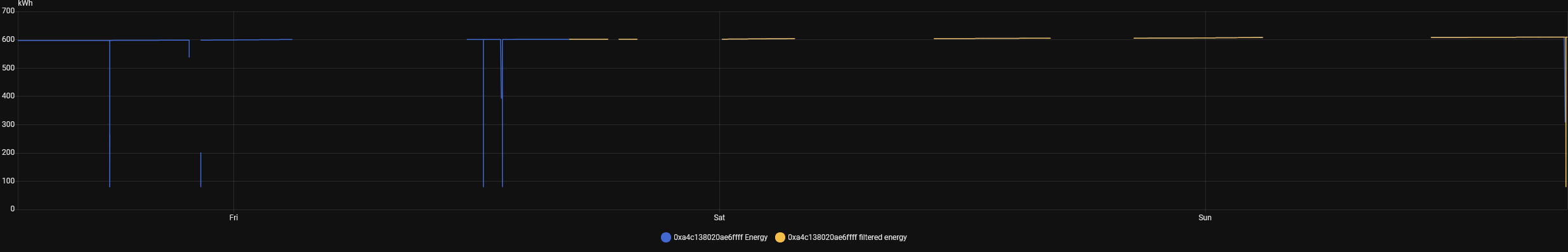

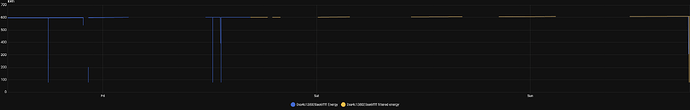

I’m noticing that the filter is not applying to past data:

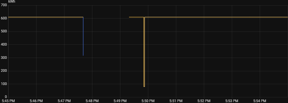

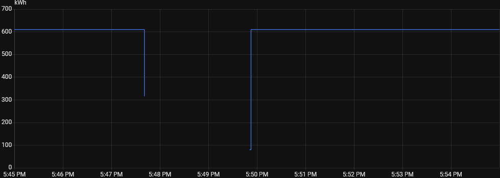

A couple more images of the difference the filter made so far:

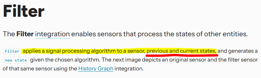

There are no filters that retroactively alter previously recorded states.Also you have to be careful with the outlier filter, especially if the erroneous values occur after a HA restart. The filter will initially record the outlier as the baseline to compare new values to.
