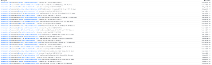

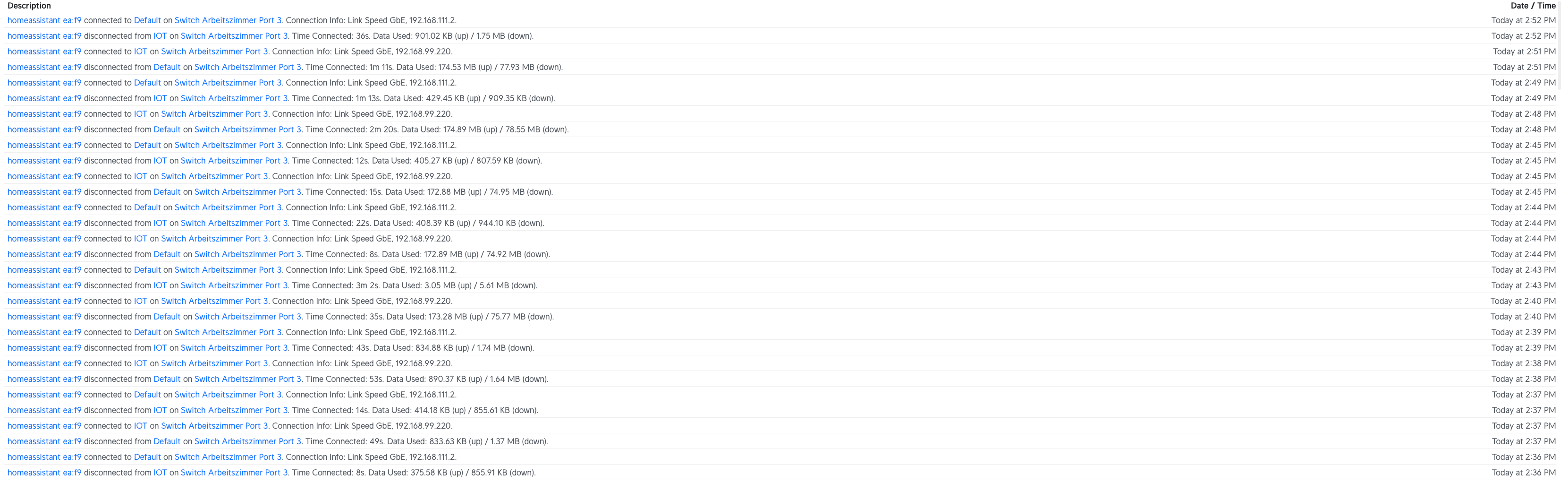

Edit: I’ve see lots of disconnects in my Unifi Controller. I will replace the ethernet cable.
IOT is a Vlan.
