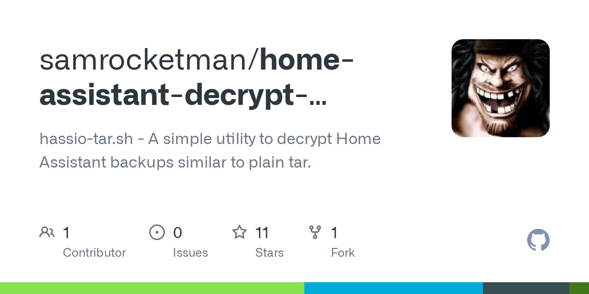

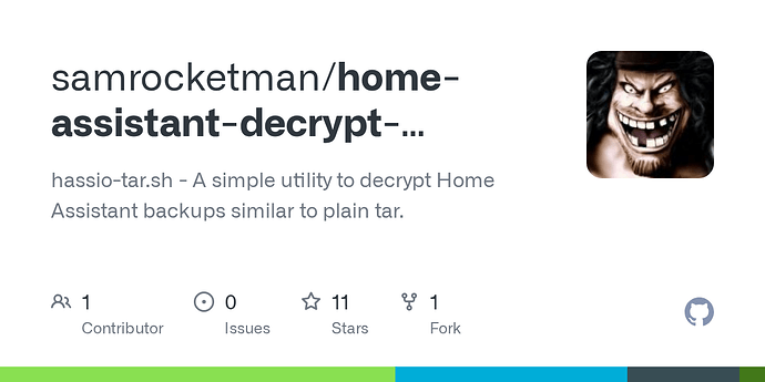

Hassio-tar - Decrypt Home Assistant backups with near-zero dependencies required
I wrote a small utility which can decrypt a home assistant backup in a way similar to using tar directly.
You download the binary from releases and you can decrypt your home assistant backups without home assistant available.
The primary use case is recovering your backups from a dead home assistant or inspecting your backups uploaded to the cloud which are encrypted.
See README for details GitHub - samrocketman/home-assistant-decrypt-backup: hassio-tar - A simple utility to decrypt Home Assistant backups similar to plain tar. · GitHub

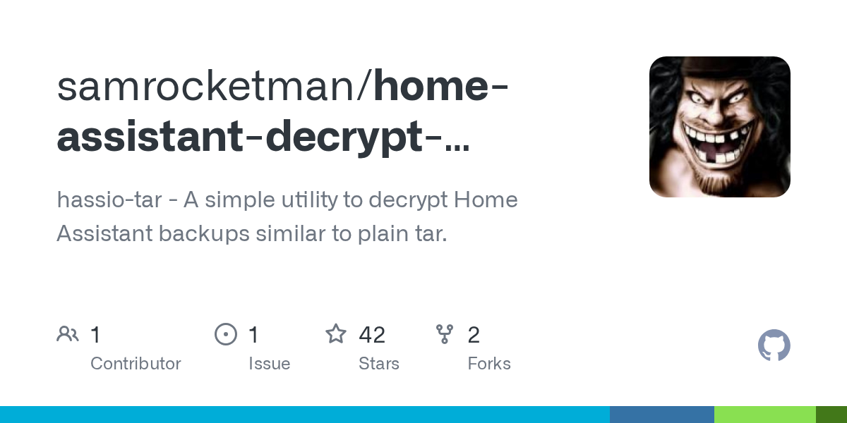

New Release v0.1.0
  • Added project license: Apache 2.
  • Added statically compiled binaries which can be used instead of the shell script.
  • Versioned GitHub releases.
  • Continued support for the shell script in case that’s your preference.
The pre-compiled binaries is now recommended instead of the shell script because they have no dependencies, decrypt in-memory, and performs a SecureTar integrity check. Support for Linux, Mac, and Windows for multiple CPU architectures.

In my post there’s a link to GitHub releases. Windows binaries are there as well.
You have to click “Show all 20 assets” because GitHub UI hides some of them.
